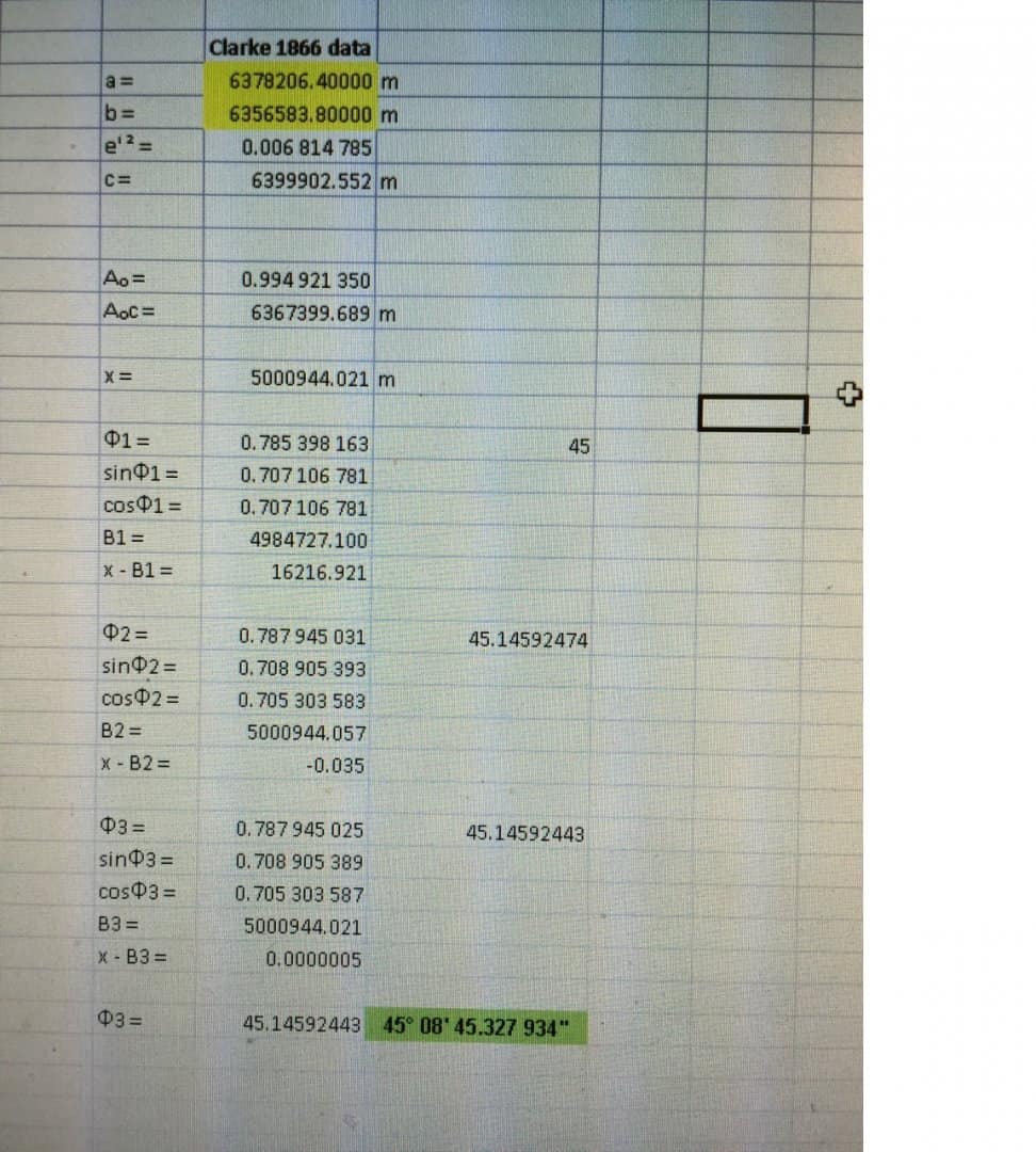

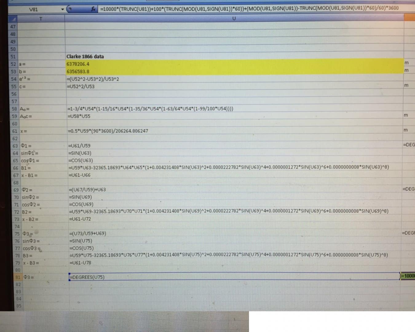

scott-zelenak
(@scott-zelenak)
Posts: 601
My data run through an iterative process.
I had 0.000 000 5 left over.
So call me a slacker for not doing another iteration.
My formulae.
Posted : February 25, 2016 8:52 am

scott-zelenak
(@scott-zelenak)
Posts: 601
Well, John I used a variant of DeLambre's 217 year old formula for solving ellipsoidal distances.
We used to do it with the TI-55 calculator but it's slightly quicker with excel.
When I want to learn something I prefer the formulas to tables or software.
If I want the answer I'll use the software. If I want the knowledge I'll work it out.
So if a 217 year old formula is a sixteen pound hammer then, oh well, guilty as charged.
And sometimes the point isn't to get the correct answer to ten decimal places, it's to inspire critical and logical thought in the generation that has the unenviable misfortune to replace us.
