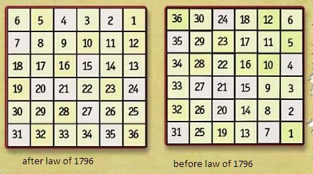

.. In a standard Township you begin with Sec. 1 at the Northeast corner, then proceed West with the numbering until the Township line, then drop South for Sec. 7 and continue East repeating the process until Sec. 36 at the Southeast corner. Is this correct ?
The reason for the question is years back i read some on the PLSS and it was mentioned that the sequence of Section numbering wasn't always a hard fast rule, and that in some few cases the numbering sequence followed a different route. Did I misremember what I thought I read, or did this actually occur ?

You have it correct. As the ox plowed the field.
Other methods were tried in a part of Ohio in the early days.

from THE OFFICIAL OHIO LANDS BOOK issued by the Ohio State Auditor
