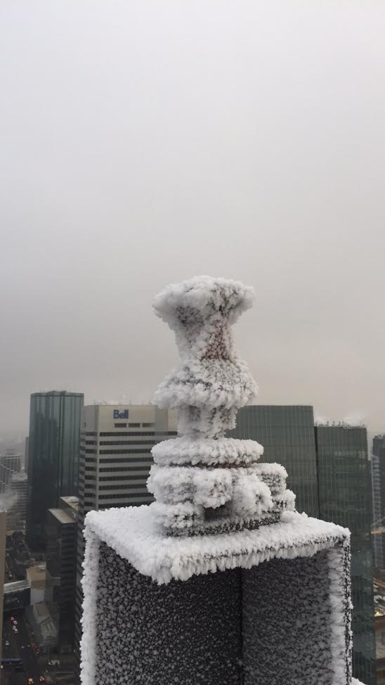

any idea how to prevent this from happening haha.......

Do you have power near these points?
Posted : December 2, 2016 5:17 am
Smaxwell
(@smaxwell)
Posts: 57
some of them yes..............i think it could be arranged
Posted : December 2, 2016 8:51 am
mvanhank222
(@mvanhank222)
Posts: 374
What about pipe heat cable
Posted : December 2, 2016 10:56 am

Could you build a box to put over these set-ups, when they're not being used?
Just a thought; I've never had this problem, so I could be totally wrong...

If you can get power to it then you could use a reptile heating pad and a terrarium glass bowl. Maybe?

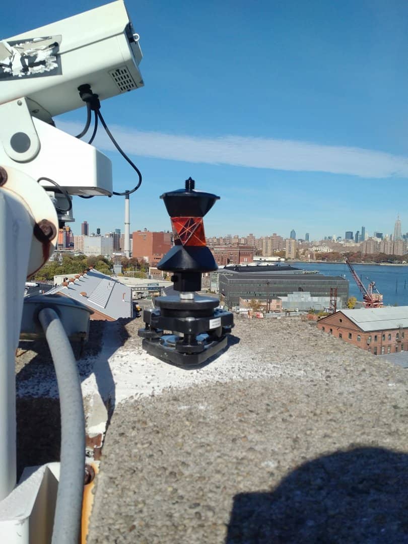

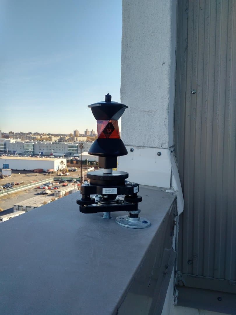

Made the same choice with the Leica GRZ4. We run 2 Sokkia robots, 1 Leica & 1 Focus. All on Carlson exempting the Leica, that's on Captivate.

I lied, they are GRZ122's...
Next project I think I will mount the Sokkia ATP1's, shorter and thinner so hopefully less subject to wind. The price is just hard to swallow.

There is a knock off ATP1 for I think less than half The price made by Adair or Site Pro I have not used, tested, or seen one in person. It may be worth checking out or the tdr360 a 360 degree retroreflective target may be worth looking into.

1st I've seen that tdr360å¡, interesting product @ a great price. I wasn't able to find a spec on the ppm but I'd worry that with such a large offset (76mm I believe) it would incur some error when hitting it from steep angles or it lost a little plumb in the wind.
Sokkia also sells a 'Builders" 360å¡ that sells for $700 å±, less than å? of the ATP1, the ADIRPro is $400, again, can't find specs on these either.
GRZ122 & ATP1 both are both spec'd @ å± 2mm + 2ppm
