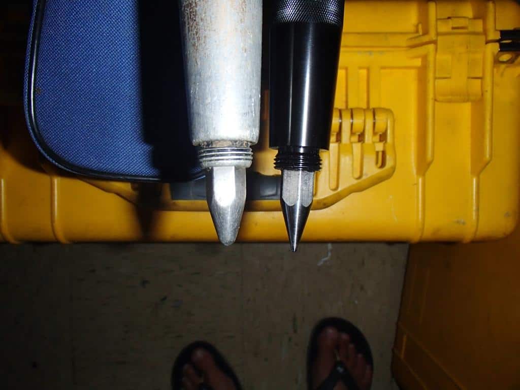

Here's a good reason to replace the points (or remeasure), the one on the left was about 2 years old and had endured I'd say on average 1 out of every 3 days RTK use, but including a 60,000 point urban road survey - we then came to using it for total station work, and got all worked up, "anti-east" (where these poles come from), when it appeared that it didn't give a correct pole height, until we realised what had happened. The one on the right is 5mm longer and is on a new pole. We have a couple of new points, and have had a crack at removing the old one but failed, so we will have a crack using the methods in this thread.

Richard Imrie, post: 410378, member: 11256 wrote: including a 60,000 point urban road survey
This is the reason I keep a topo shoe on the pole except when shooting control points. It saves the point from a lot of wear.
Posted : January 22, 2017 11:32 am

Jim Frame, post: 410397, member: 10 wrote: This is the reason I keep a topo shoe on the pole except when shooting control points. It saves the point from a lot of wear.
Also keeps the shot on the surface and not 1 or 2cm down.
