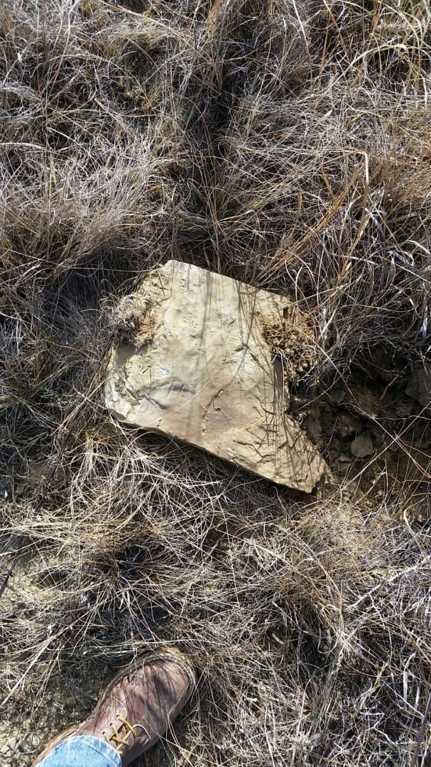

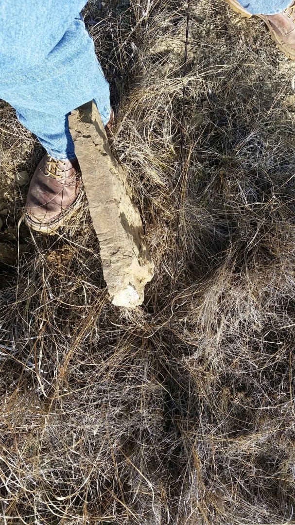

Finally found this one, was a frustrating experience, the third time looking.
dug it out from under a fence, buried about 3"
this is the east face, so you can figure out which corner it is.
