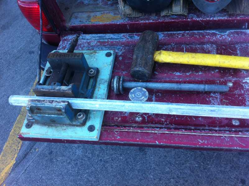

Larry Best
(@larry-best)
Posts: 760
https://surveyorconnect.com/attachments/021-1-jpg.2285/?temp_hash=e8429828814be5b8828532af09c24768
This is what I use and it works great.
I cut pipe (3/4" nominal) to length with a pipe cutter and the pipe in a vise on the tailgate.
The bolt is much better than the pipe driver I got from Brentsen. I've named it Usain. The bigger the bolt the better. Lots of heavy washers helps too.
Don't drive with a maul or small sledge. The bigger the hammer the better.
A bigger hammer and a bigger bolt transmit the same force over more time so there's less mushrooming of the pipe. I think that's why it works.
My only complaint is that the Brentsen cap with plastic insert gets cocked a little if not careful.
