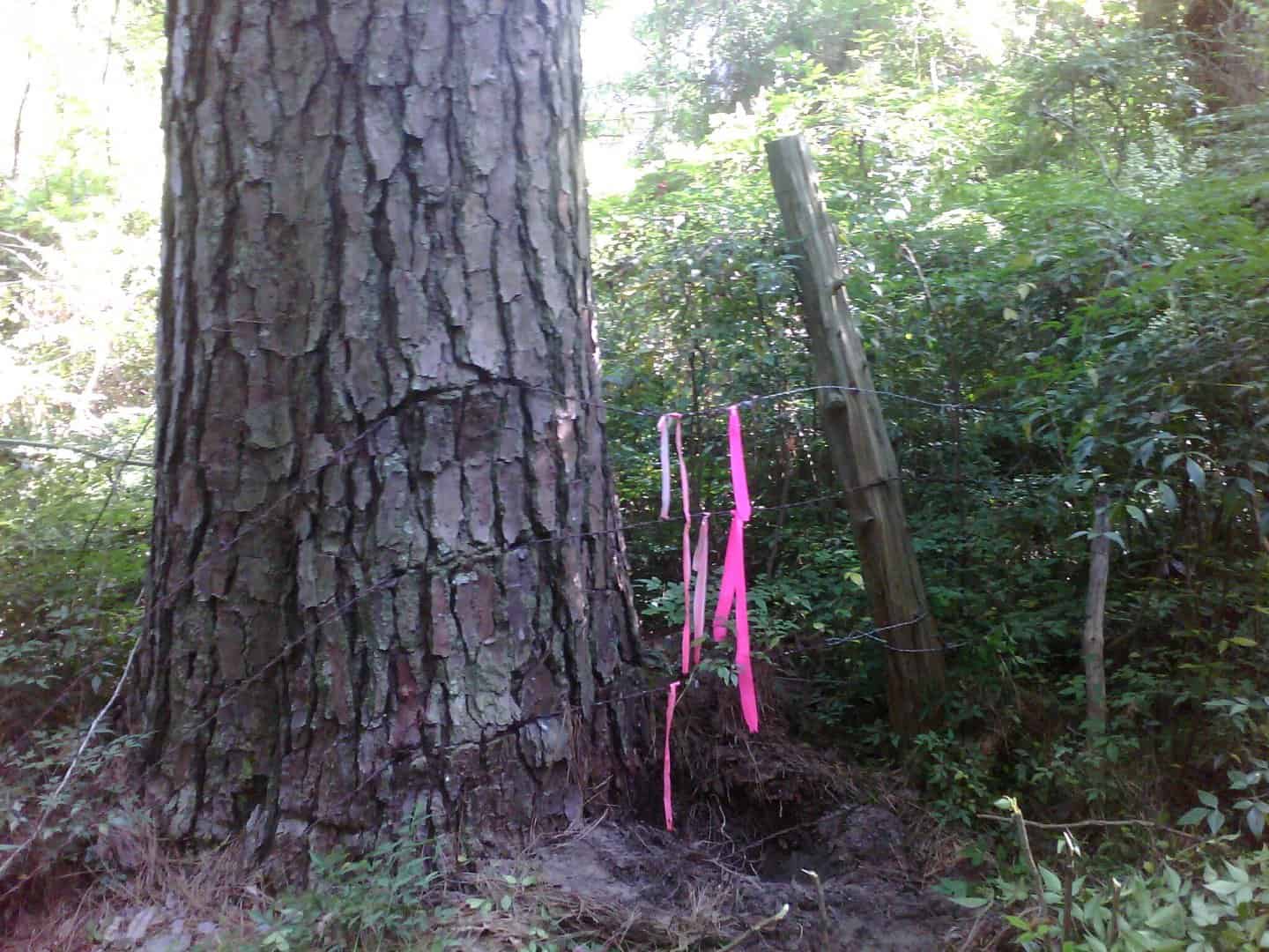

I was able to locate the 5/8" rebar at the Northwest base of this 36" pine tree a couple of days ago. It took about 11 minutes for me to get all of the checks I wanted before I called it good. It was on a smallish lot, but was through woods and underbrush across a small creek. Working solo, it made a lot more sense to use RTK instead of conventional traverse. After evaluating the adjoining surveys, I discovered this wasn't the corner I thought it was. There were two more stakes I returned to find and tie in yesterday. One was 9 feet Southwest and one was 6 feet West. I was also able to tie those in. Beyond this pine tree, there was a canopy of deciduous and pine trees overhead and to the North (along the creek).
As I explain to people, the calculus of getting the gun out or using RTK changes quite a bit when you go from two-man to solo. In this instance, it's difficult to say if a two-man crew with a total station would have been more efficient than one man with RTK. How long would it take set a couple of traverse points to get to this point, clearing the underbrush to prep the traverse and then running it. I'd wager more than the 11 minutes it took to get there. However, the two-man crew may have beat me going back to tie in the two additional stakes (a railroad spike and another 5/8" rebar). But even that may have been a draw.

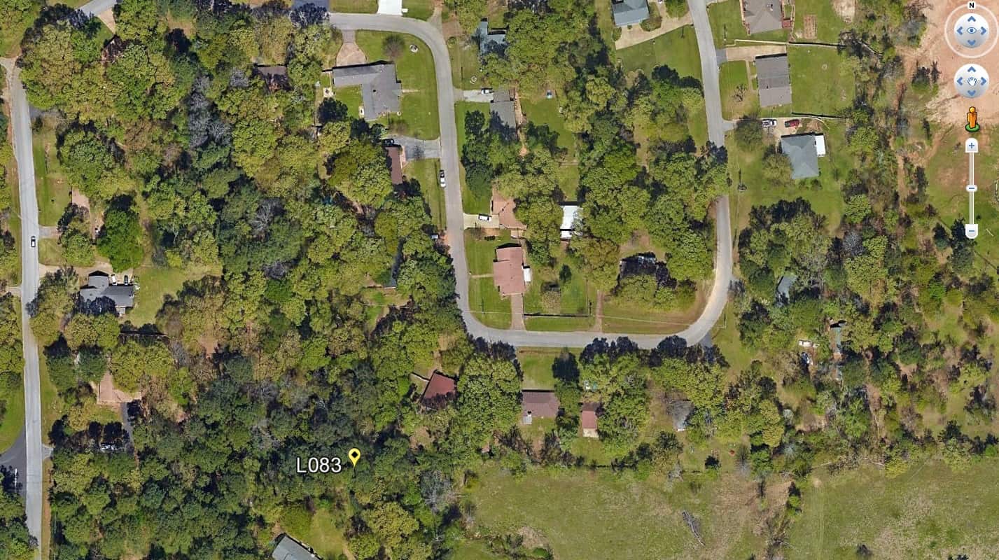

Here is a Google Earth image of the point from overhead

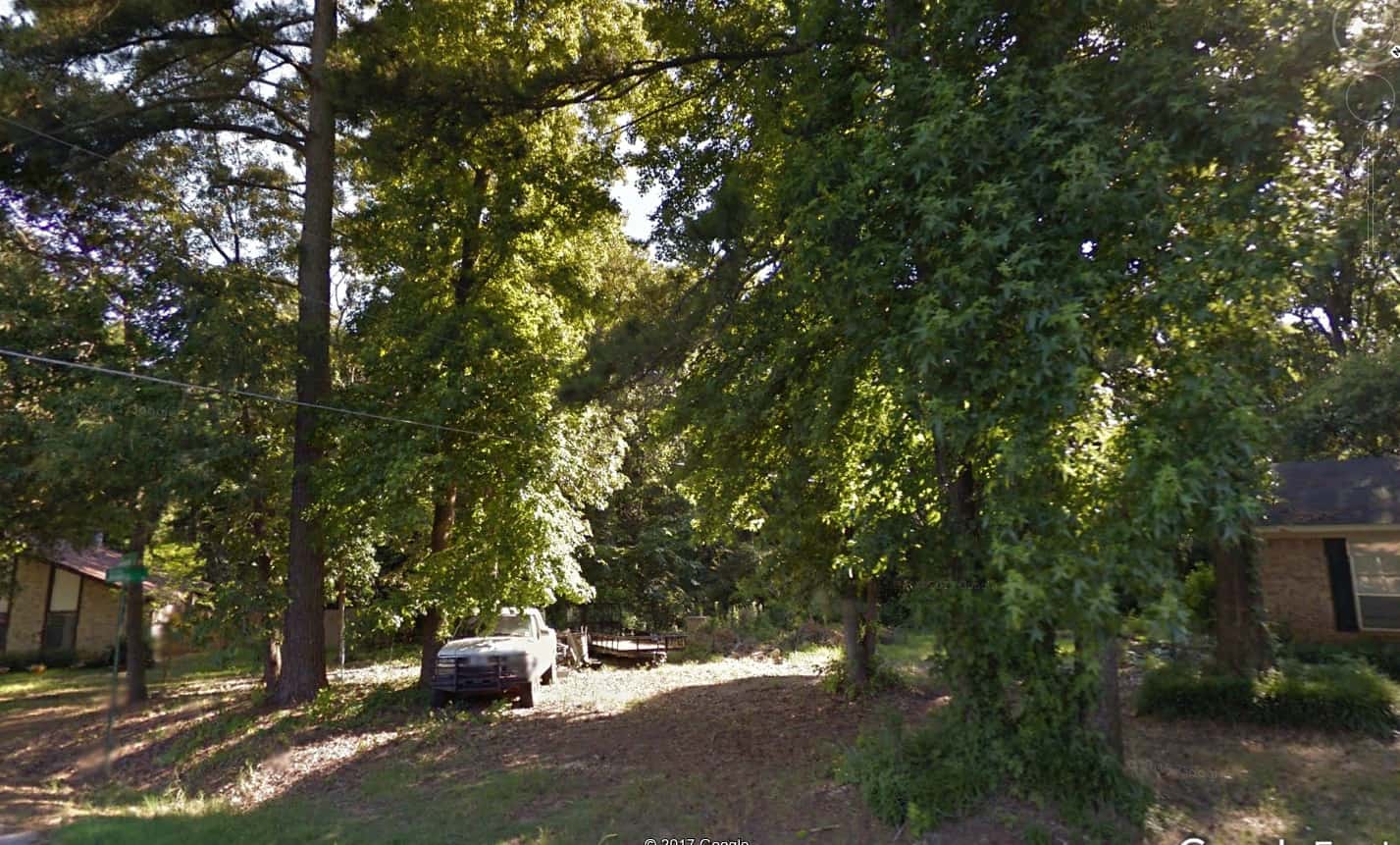

Here is the street view from the sharp bend in the road Northeast of the point looking back to the Southwest (just to get an idea of the type of canopy in the vicinity.

Shawn Billings, post: 427473, member: 6521 wrote: I was able to locate the 5/8" rebar at the Northwest base of this 36" pine tree a couple of days ago. It took about 11 minutes for me to get all of the checks I wanted before I called it good. It was on a smallish lot, but was through woods and underbrush across a small creek. Working solo, it made a lot more sense to use RTK instead of conventional traverse. After evaluating the adjoining surveys, I discovered this wasn't the corner I thought it was. There were two more stakes I returned to find and tie in yesterday. One was 9 feet Southwest and one was 6 feet West. I was also able to tie those in. Beyond this pine tree, there was a canopy of deciduous and pine trees overhead and to the North (along the creek).
And what receivers did you use here Shawn?

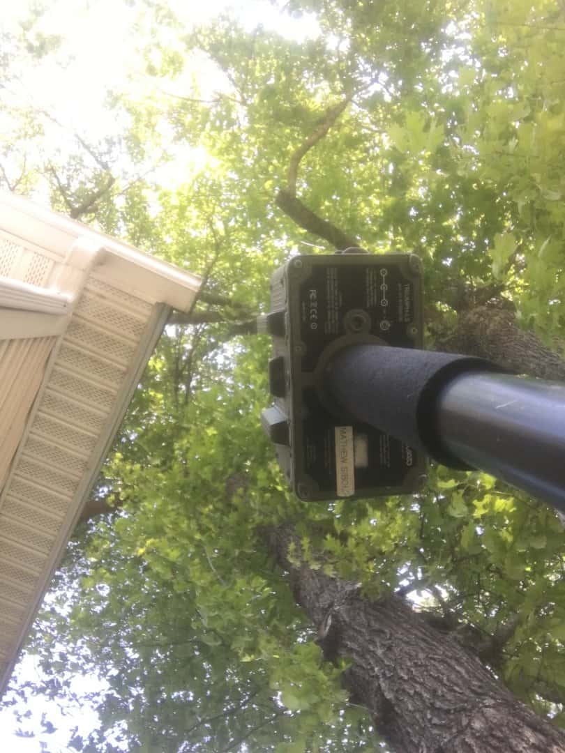

I was able to get two separate RTK shots on this pin which was then checked with PPK which all agreed within 05'+100ppm to the next two pins ahead and back of this pin which also checked within 0.10 to the record description.
Regardless of what equipment you are using redundancy is key to knowing if you have good data.
The redundancy that I have on the pin in the picture is 2 separate RTK shots, 2 separate PPK shots and a separate comparison using the relative accuracy calculator built into the Javad software to make sure I met minimum standards.

mattsib79, post: 427614, member: 1138 wrote: I was able to get two separate RTK shots on this pin which was then checked with PPK which all agreed within 05'+100ppm to the next two pins ahead and back of this pin which also checked within 0.10 to the record description.
And if I know your procedure, that wasn't just two RTK shots, it was two RTK shots that each included multiple resets of the engines to verify the fix that was being reported.

BushAxe, post: 427593, member: 11897 wrote: And what receivers did you use here Shawn?
Javad Triumph-LS as rover, Javad Triumph-2 as base paired to a HPT435BT 35watt radio. Baseline length was about 1800 feet.
