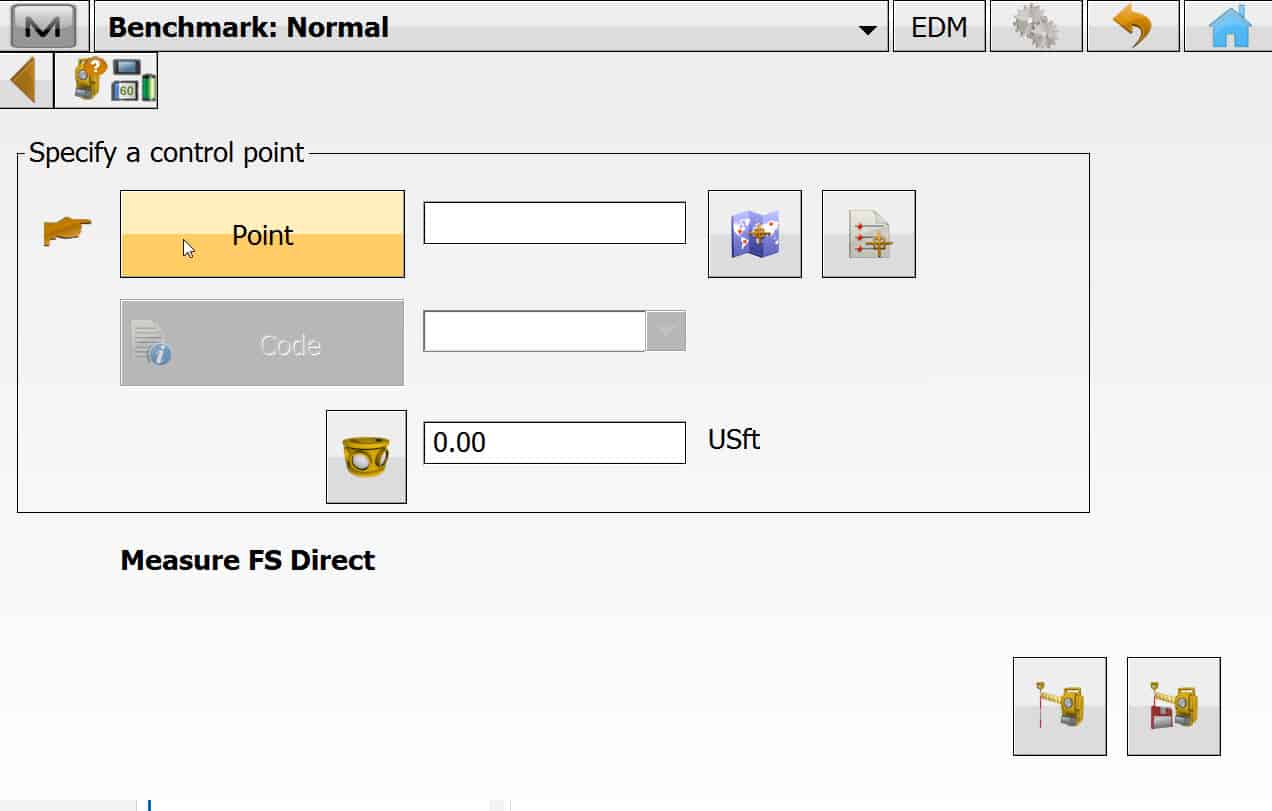

One of my biggest things is what most software call "remote bench" I never set my HI as I believe the tape measure method to not be accurate so what my procedure is to set rod height then shoot the bench, where my issue is with some software packages is they now want X and Y on the point some of these points I don't have that established and shooting then editing the Z value and taking the shot is something i feel unnecessary. With SurvCE at least the version I've Been using I can just specify and elevation shot it, do a check shot and be done. When I did the Magnet demo yesterday you had to still create a point X and Y could be 0 but you still have to create a point again unless there's a trick I don't know.

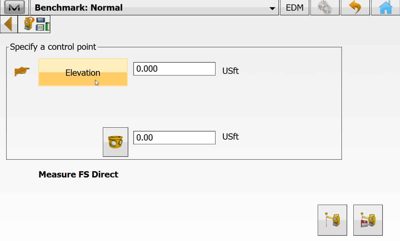

I hate seeing post's like this where the OP can't find the correct routine when it is right in front of them, and the sales rep can't help.
When using the "Remote Bench" routine in Magnet (it may be same in TopSurv), just tap on the button labeled "Point" and it will change to "Elevation".
Any time you see the hand pointing to a dialog box in Magnet, there are more options, just click to change selection.

Ha I knew there had to be an easier way, I've seen you posting on other various posts about Magnet and its capabilities do you have any experience with Carlson? i'm kind thinking at this point I should just go with the GT and FC 5000 Running magnet over the sokkia and a Carlson setup.
