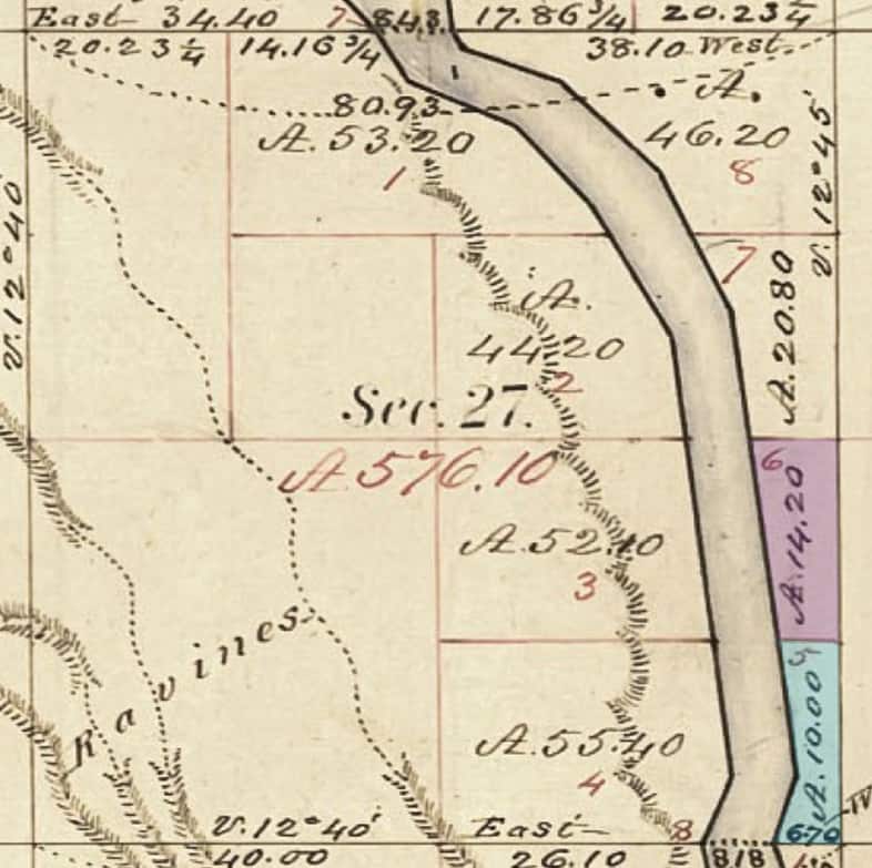

I am trying to figure out if there was a set rule for fractional lot size. In many cases if an aliquot lot could be made with 40 acres within a section it was not given a lot number. However, in the example here from 1870, Lot 4 in Section 32 has 61.80 acres. Lot 4 in Section 30 has 27.30 acres and the SW 1/4, SE 1/4 was left alone as an aliquot part and not numbered instead of making Lot 4 to be 67.30 acres. An aliquot part of Section 32 could have been made with Lot 4 adjacent to the river having 21.80 acres. What was the rule here for determining when to cut off or include acreage for a lot?

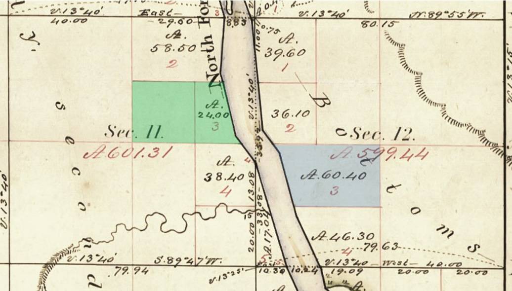

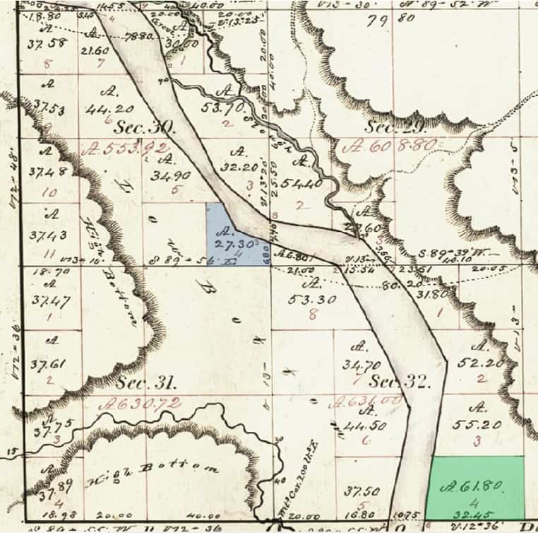

It seems the 1855 Manual likes refers to the diagrams quite a bit for guidance. Here is an example from Diagram B which shows three small lots at the top of the section, but two at the bottom that could have been two aliquot parts and two lots with 9.66 and 10.62 acres. They also give the SW 1/4. SW 1/4 a number (Lot 6), but this is an aliquot part and would therefore not be numbered.

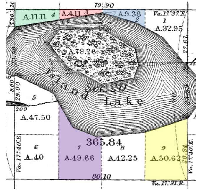

Loyal is on the right track, I haven't looked at that particular manual, but all the manuals have had maximum and minimum desirable lot sizes, that can be in conflict with instructions to avoid lots that cross center of section lines and center of 1/4 section lines. Each offical in charge is left on his or her own in deciding how to deal with situations that need to violate at least one of the rules.
The bigger question is why the island in section 20 was not lotted.
