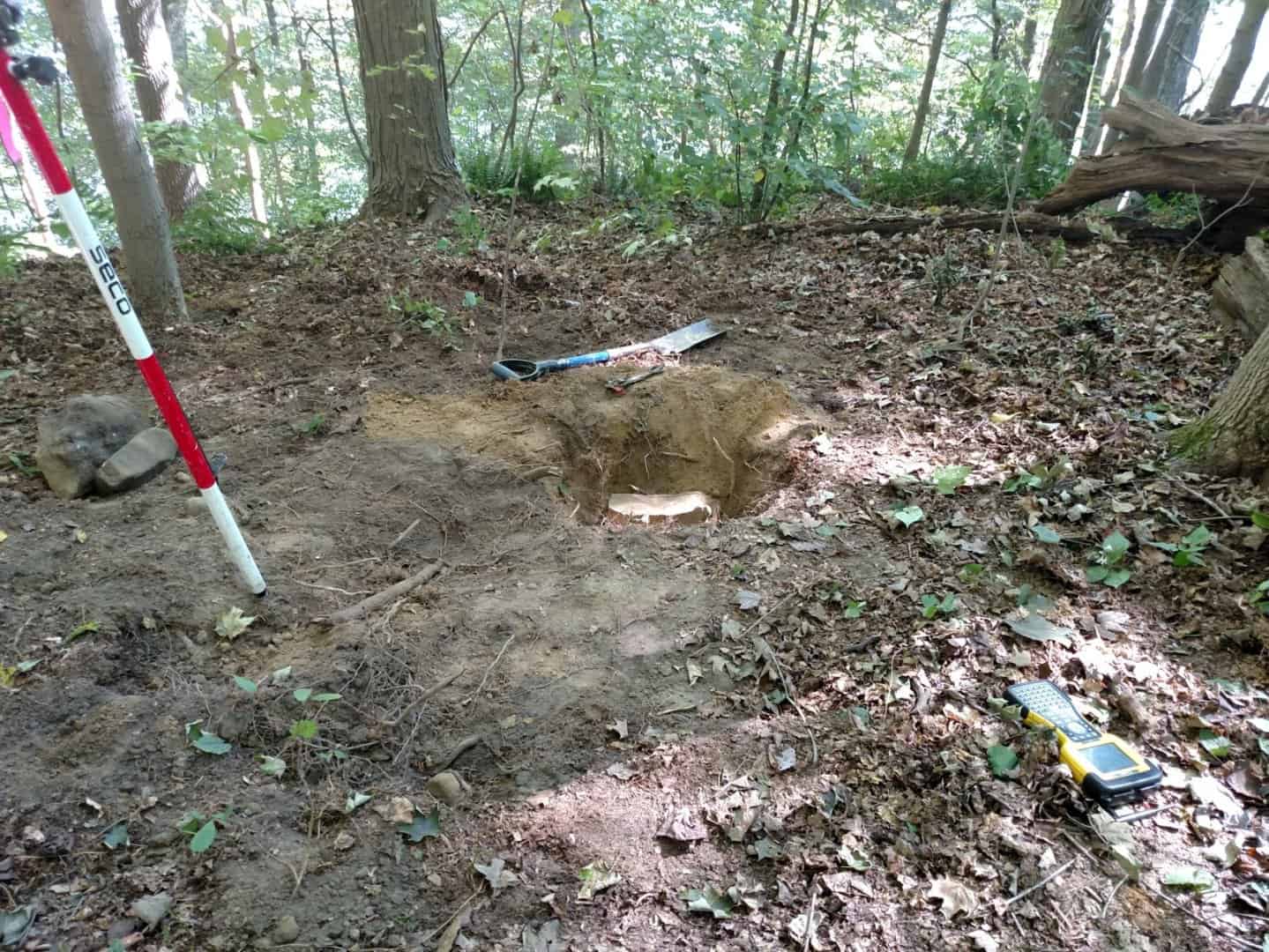

I have almost never seen elevations labeled on boundary monuments.
This month we are working on recovering and surveying sedimentation range monuments on a reservoir project, most of which are also boundary monuments, which were all set stones. We have a list that has a short description ("+ cut 5" X 6" set stone" or "+ cut on 2' X 1.3' boulder", etc) and also an elevation. The boundary mons all have NAD27 SPC as well, but those coordinates were determined by traverse in the late 30's and early 40's, so there is some slop in them.

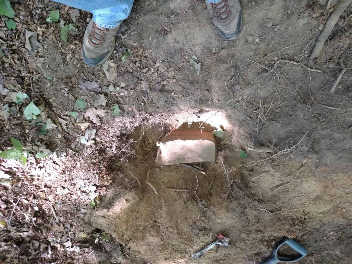

In one case we found an iron pin in a yard where a set stone was called for. We were wondering whether to dig down, but it turned out the ground was 1.8 feet lower than what the top of stone was, so that was pretty obvious that it was gone (graded). At another site we traversed into the woods, found nothing on the surface, and it was described as a 4" X 4" set stone, 0.4' above ground. We found this:
Obviously not 4" X 4", and other ones were always accurately described in their dimensions. This stone was in SOLID, so I assume it was probably the "set stone", but the dimensions don't match. Probably had a tapered top that came up above the surface that had been broken off. Note the nail with pink flagging and target material we found nearby. The elevation of the remaining top was too low by about 1 foot. another pic:
So, question is...since a lot of work is being done by GPS, why not put an elevation tag on the plan, wouldn't that make it easier to determine if the monument is under fill, or graded out?

I have made it a practice to record rod heights/elevations on monuments for my own information. That way, if i ever suspect a monument of being tampered with, I have an X, Y, and Z to check.
When I make a map, I generally note if I found the monument at grade, or, how much +/- above/below it was at the time of the survey.
I think it adds an extra layer of useful information to a map to help someone in the future.

Nice pic's, I note on my plat how far above or below grade the monument is. I have only done a few surveys where I didn't carry elevations. It's so easy and it provides an additional check in your work. It's not really been that useful to me, but once or twice it has paid off. I think it's a good practice. I haven't seen many other recorded plats in my area that reference the above/below or elevation of a monument, unless it was held as a benchmark.
