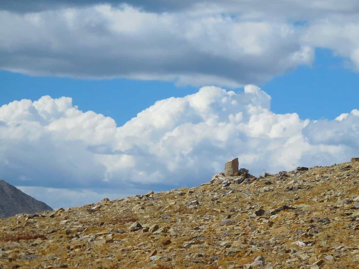

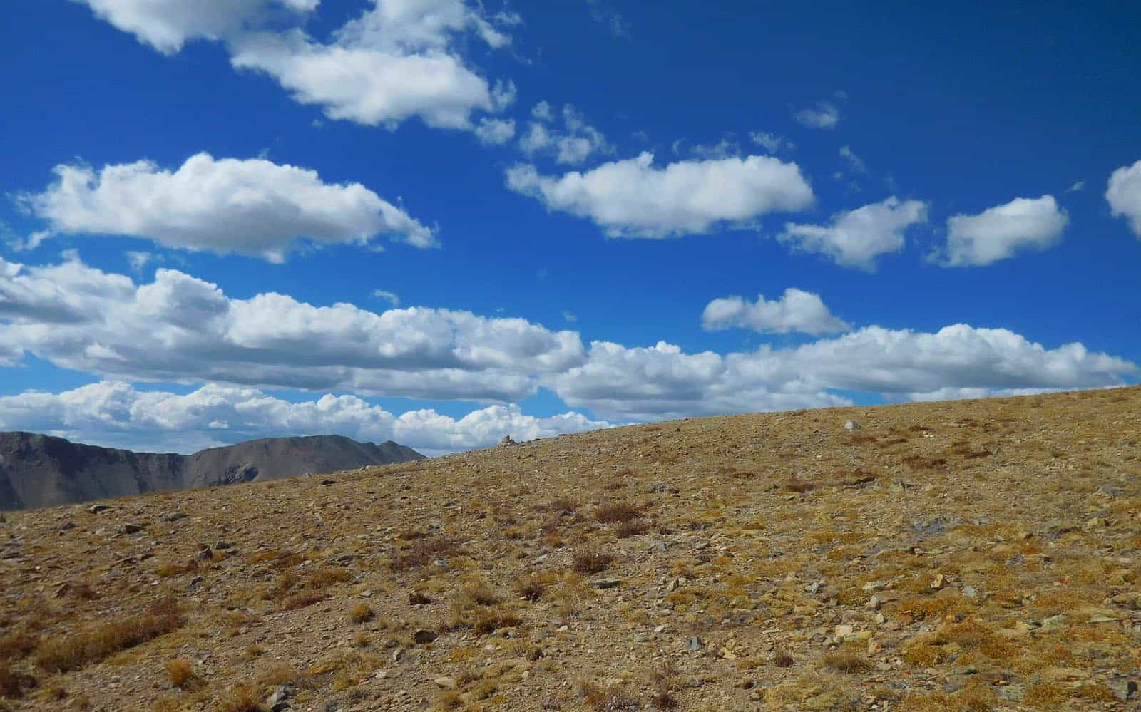

Don't know why I can't edit the previous post to add a couple of photos....oh, well.
From today's outing, a close-up and photo of Cor. No. 3, Social Fund Lode, ellipsoid height = 13,403.64 ft.; orthometric height (from GEOID12A) = 13,445.68 ft, NAVD88
