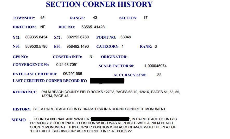

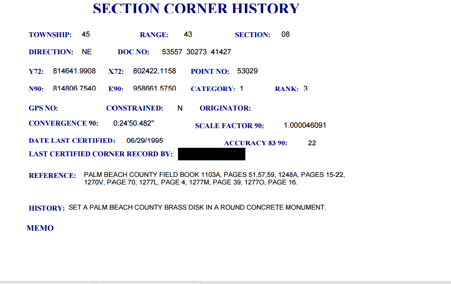

Here is the county corner record.
Posted : April 16, 2016 9:38 pm

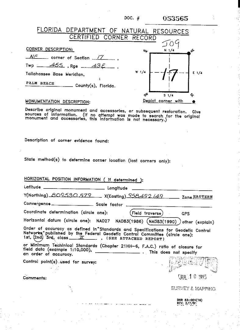

Here is the record referencing the '90 adjustment Loyal is talking about.
Posted : April 16, 2016 9:49 pm

X72, Y72?, is that a county coordinate system? I see it was done in 95 on a NAD83 (90) system. Here the big shift in coordinates was (86) to (93), one local county has a 88 system, and no they aren't confusing NAVD88 with NAD83 it's just when they got the system going. These coordinates were done conventially, not GPS?
Posted : April 17, 2016 5:54 am

MightyMoe, post: 367710, member: 700 wrote: X72, Y72?, is that a county coordinate system? I see it was done in 95 on a NAD83 (90) system. Here the big shift in coordinates was (86) to (93), one local county has a 88 system, and no they aren't confusing NAVD88 with NAD83 it's just when they got the system going. These coordinates were done conventially, not GPS?
Apparently it was done conventionally with class II accuracy. Not too much more to go off of.

Brian McEachern, post: 367717, member: 9299 wrote: Apparently it was done conventionally with class II accuracy. Not too much more to go off of.
So this looks likes a record of somebody developing a geographic position for the corner.
Are there no records of how the monument itself was established?
Sure makes me glad to work in a recording state where corner history is easier to develop and verify (usually).
Posted : April 17, 2016 8:46 am
Kevin Samuel, post: 367727, member: 96 wrote: Are there no records of how the monument itself was established?
I'm going to guess that the basis for re-establishment of that corner is indicated by the following note that appears in the "Section Corner History" record above:
"This corner is in accordance with the plat of 'High Ridge Subdivision' as recorded in Plat Book 22"
What I get out of that is that the section corner was shown in relation to some monumented corners of lots or blocks on the plat of High Ridge Subdivision and ties from those provided the control from which the section corner was determined. The multiple opinions may reflect the position of the section corner as determined from alternate subsets of subdivision monuments. Just a guess, though. It would be interesting to know.
Posted : April 17, 2016 9:21 am
