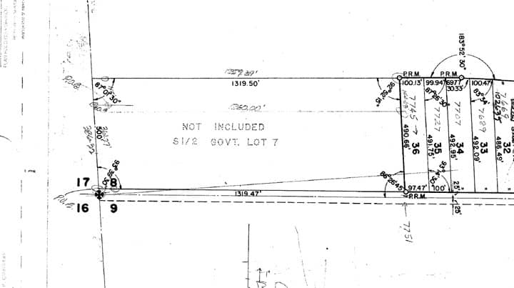

MightyMoe, post: 367776, member: 700 wrote: Looking at the cap makes me wonder if the center dimple was originally stenciled, the second one is probably a guy with GPS.
From looking at the 1947 plat of HIGH RIDGE SUBDIVISION that shows a tie to the section corner, it appears that the corner may have been re-established from some permanent reference marks about 1320 ft. distant using a tie that was TAPED in 1947. The horizontal distance between the punchmarks (0.03 - 0.04 ft., I'd guess) could be two different attempts to lay off the taped distance using EDM ranges. Either way, wow.

Kent McMillan, post: 367782, member: 3 wrote: From looking at the 1947 plat of HIGH RIDGE SUBDIVISION that shows a tie to the section corner, it appears that the corner may have been re-established from some permanent reference marks about 1320 ft. distant using a tie that was TAPED in 1947. The horizontal distance between the punchmarks (0.03 - 0.04 ft., I'd guess) could be two different attempts to lay off the taped distance using EDM ranges. Either way, wow.
Since it's a section corner, they would probably have more info than that from property west and south, although the indication is that some of it is federal. It may be fed to the west and south so there may be no surveys those directions

MightyMoe, post: 367785, member: 700 wrote: Since it's a section corner, they would probably have more info than that from property west and south, although the indication is that some of it is federal. It may be fed to the west and south so there may be no surveys those directions
I was relying upon the note on the "Section Corner History" sheet that says:
"This corner is in accordance with the plat of 'High Ridge Subdivision' as recorded in Plat Book 22"
Obviously, I'm in Texas, but I understood that to mean that the representation of the position of the section corner on that plat of record was considered to perpetuate the corner. I make no judgments.

Kent McMillan, post: 367788, member: 3 wrote: I was relying upon the note on the "Section Corner History" sheet that says:
The corner was replacing an existing monument with a PLS stamp, I guessing since it's blacked out. The subdivision is supportive evidence,,,,,, there is no doubt more history in the record,,,,
