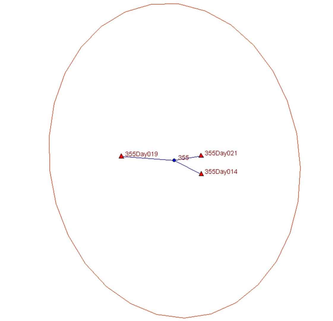

Across the road from a project I'm working on at the moment is a control point that I positioned a little more than eleven years ago via OPUS. The station is marked by a punchmark on an aluminum cap affixed to a #5 rebar driven into a hole drilled in a hill of weathered limestone. The station had an unobstructed view of the sky and was fairly well protected by being within a chainlink fence enclosure. As OPUS points go, I consider it nearly ideal.
The positioning was done by just parking an L1/L2 GPS receiver (Trimble 4000ssi) with a geodetic-grade antenna (Trimble L1/L2 Micro-centered, compact antenna + GP) on the station and logging observations for between 4hrs30min and 4hrs56min.
Fast forward eleven years and I'm interested in deriving the NAD83(2011)Epoch 2010.0 position of the punchmark. The obvious solution was to just resubmit the old observations to OPUS and readjust the results. In 2005, I'd just settled for the Rapid orbits, but now the Final orbits were available and the new solutions were quite good.
The individual OPUS solutions reported the following peak-to-peak variations for three occupations of the same Rod and Cap No. 355 on three different days:
355Day019 2mm Lat / 1mm Long
355Day014 6mm Lat / 3mm Long
355Day021 3mm Lat / 2mm Long
I adjusted the three OPUS positions in Star*Net using the variances and covariances reported by OPUS and determined that the least squares estimate of the position of Rod and Cap 355 differed by the following amounts from the three separate solutions:
355Day019-355 = 0.9mm Horiz
355Day014-355 = 0.5mm Horiz
355Day021-355 = 0.4mm Horiz
Here's a picture of the relationship of the least squares estimate to the three separate OPUS solutions:
The ellipse is the 95% confidendence error ellipse that Star*Net estimated for Control Point No. 355 plotted at the same scale as the points.
It has a semi-major axis of 2.6mm and a semi-minor axis of 2.0mm, so on paper it is probably the best positioned point for at least a couple of miles.

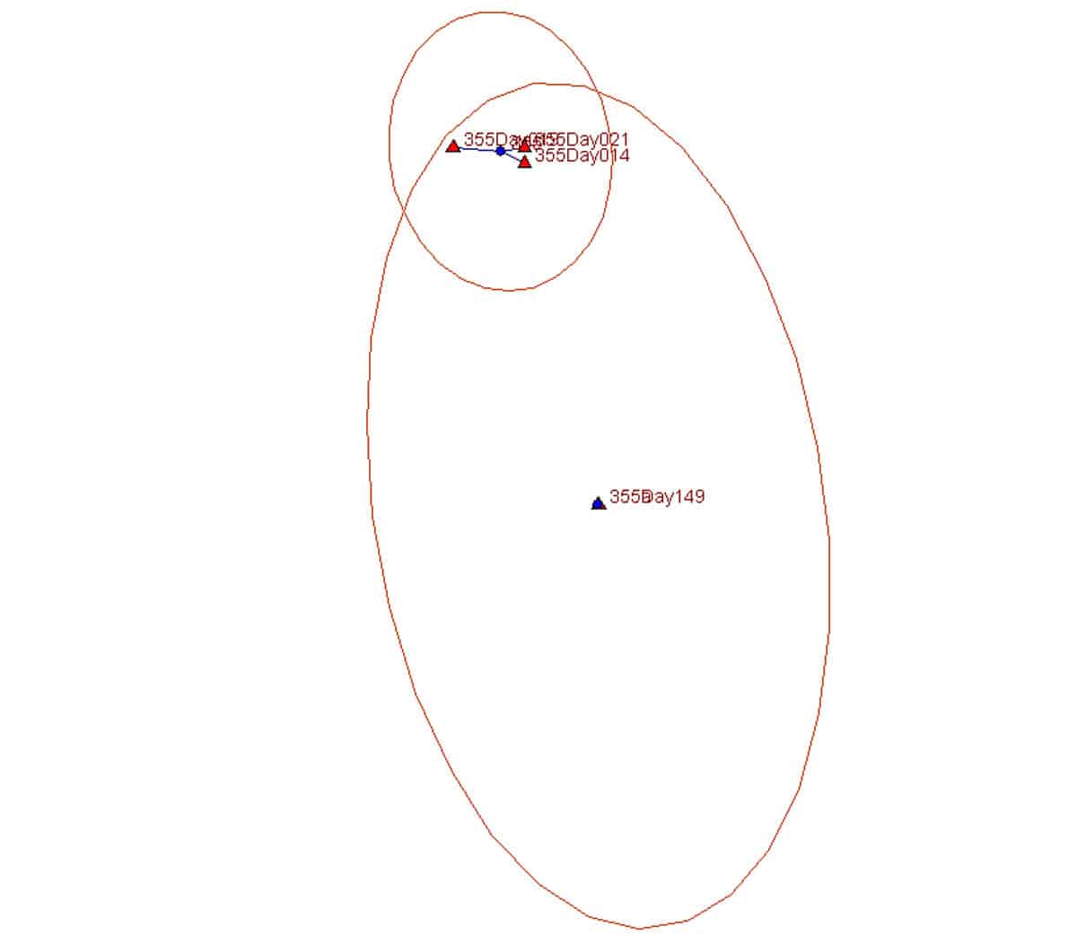

But the lingering question was how well simply reprocessing the old data in OPUS served to produce an updated NAD83 position. So I climbed the chain link fence again and set up a GPS receiver on the same point, logged data, and submitted it to OPUS.
There were logistical problems and I only got 2hrs49min of observations, but I sent that session to OPUS, anyway.
The image below shows the 95%-confidence error ellipse associated with the solution that OPUS returned for the new work. As may be seen, the 95%-confidence error ellipse for the 2016 session on the same control point does contain Point 355, the least squares estimate of the position of the control point from the 2005 work. So, at first impression, there is no obvious problem.
In any event, the horizontal distance between the 2016 solution and the least squares estimate of the 2005 positions is only 6mm.

I take it that this new observation is an ultra-rapid solution. Once you reprocess with the precise the ellipse should get smaller. Hopefully the ellipse will also move so that it continues to encompass the older solutions.
If not, well, crustal movement in Texas is not so great as it is on the west coast, but, nevertheless, it is happening. Could be that part of Texas has moved a few millimeters in 11 years.

6mm in 11 years ... could it be tectonic plate shift?

The new observations were reduced in OPUS using Rapid orbits.
The new OPUS solutions from the 2005 observations, though, regressed the current NAD83 (2011) Epoch 2010 positions of the CORS antennas back to those of the epoch of the observations in 2005 using the NAD83 velocities of the stations. I interpret the small peak-to-peak variations in the new OPUS solutions from the old observations as a validation of that method.

The 6mm is more likely just the uncertainty inherent in the newest OPUS solution that was derived from only 2hrs49min of observations using rapid orbits.

Yes, I would expect that the main reason for the 6mm difference in the current solution is just that the session was short (<3hrs) and so would be expected to produce coordinates with a horizontal uncertainty of more than 6mm. I'm going back to the site this afternoon and will park a receiver on the point for another OPUS solution that should tell the story.
