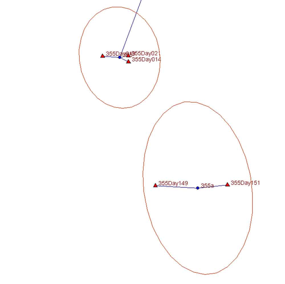

Today's reoccupation of Rod and Cap 355 gave an NAD83(2011)Epoch 2010.0 position that was essentially consistent with that of two days ago. Today's was based upon 4hrs06min worth of observations and that of two days ago upon 2hrs49min. I used the covariance matrices that OPUS reported for the most recent two days to adjust the position of the punchmark on the Rod and Cap as Pt. No. 355a.
The agreement of the recent results is seen in the following residuals:
355Day149-355a = 2.0mm Horiz 4.9mm Vert
355Day151-355a = 1.5mm Horiz 2.0mm Vert
The fact that the 95%-confidence error ellipses of 355 and 355a (plotted to scale below) do not overlap indicates that the two NAD83 positions of the Rod and Cap, i.e. that derived in 2005 and that in the last couple of days in 2016 are significantly different.
355-355a = 8.0mm +/- 5.0mm (95% confidence)
So, in other words, just reprocessing the old GPS observations from 2005 in OPUS does not appear to be an excellent predictor of the NAD83(2011)Epoch 2010.0 position of the control point at the sub-centimeter level.

No, the epochs are identical, NAD83(2011)Epoch 2010.0 . It's possible that it partly reflects seasonal variation in the CORS antennas that isn't reflected in the OPUS solutions.
Here's a link to the long-term time series for the CORS site TXAU that was used in most of the solutions, for example.
http://www.ngs.noaa.gov/cgi-cors/CorsSidebarSelect.prl?site=txau&option=Time Series (long-term)
Note that the North component varies with a period of about 6 months and an amplitude of about 1cm. The 2005 observations were in January and the 2016 work was in late May.
Posted : May 30, 2016 9:37 pm

Except, I neglected to point out that the seasonal movement is regional. All of the CORS sites in the area show a similar pattern in their long-term time series.
So that means that the difference between the solutions from the 2005 observations and the 2016 should not be attributed to that pattern of seasonal movement.

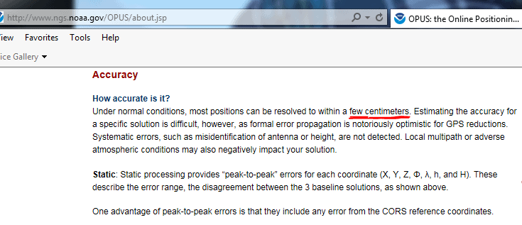

I'd say your 8mm +/- 5mm seems to be pretty good when they are taking about a few centimeters of error in the measurement...

W.W.S., post: 374790, member: 11419 wrote: I'd say your 8mm +/- 5mm seems to be pretty good when they are taking about a few centimeters of error in the measurement...
Actually, the OPUS page indicates that there is a relationship between duration of session and accuracy. For OPUS-Static, the estimate is that
Horizontal RMS = 1.0cm/SQRT(T)
where T = session duation in hours.
In my experience, that is a fairly realistic estimate of the apparent standard error of an OPUS solution as demonstrated by repeat occupations on different days.
T=4.0 hrs, then Horiz RMS = 5mm
Whether the uncertainties of an OPUS solution are realistically represented by the variances and covariances that OPUS reports (in the extended report) can be tested by adjusting repeat occupations of the same point weighted using the variance and covariances and testing the residuals of the adjustment against the a priori weights.
