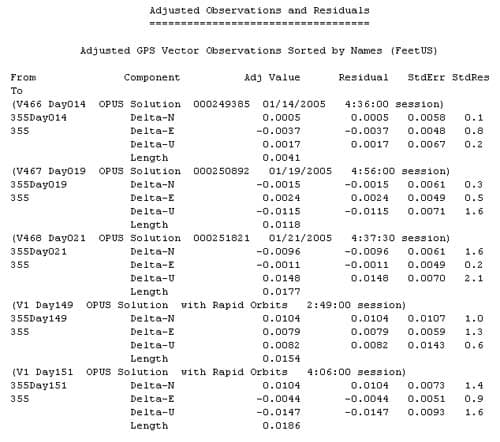

bay 149 is an outlier.....lol

355Day149 was the OPUS solution based upon a short session under 3 hrs. Since uncertainty is pretty much a function of session length in OPUS Static solutions, all other things being equal, that shorter session produced a solution with more uncertainty than the solutions from more than 4 hrs. of observations. Here are the residuals:

So, the standard residuals are all below 3 sigma?
So all the positions are valid for a weighted averaging?

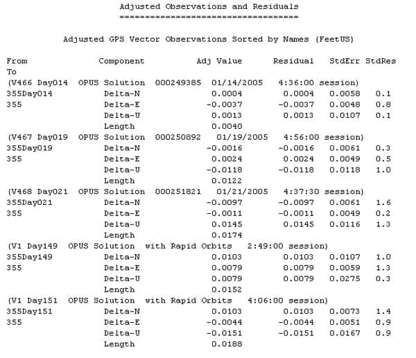

Yes. The vertical residuals are slightly on the high side, but the adjustment of the five positions passes the chi-squared test. The whole adjustment looks better if you assign a scale factor of 1.0 to the horizontal components of variances and 2.0 to the vertical, which isn't unreasonable in my experience. Here are the residuals from that adjustment scheme for comparison:
