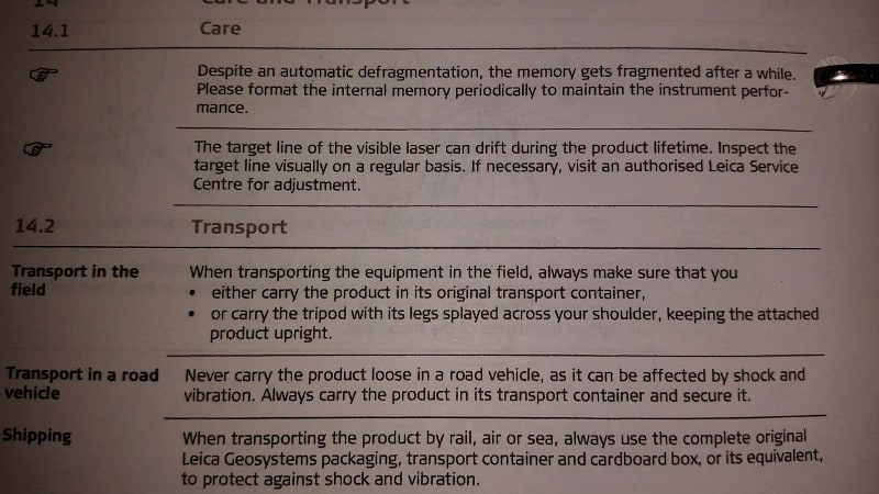

I know that there has been some discussion on here about the appropriate way to carry the instrument. If memory serves me right the most popular way was to box it and move it in the case.
I came out in the minority as one that carries it with the legs spread over my shoulder with the gun roughly level. I do buy my own instrument, in spite of one's comment on that subject.
I happened to skimming through my operating manual for my Leica TS06 and happened, accidently, across this bit of advice.
"Or carry the tripod with it's legs splayed across your shoulder, keeping the attached product upright."
I reckon that straight from the manufacturer is good enough for me.

That's been in the Leica manuals since back when they were Wild manuals.

foggyidea, post: 352898, member: 155 wrote: "Or carry the tripod with it's legs splayed across your shoulder, keeping the attached product upright."
I carry mine that way, but only for short distances over even ground. Longer distances or rough terrain get the box treatment.

If you're carrying it on the tripod, you'd better not trip or even stumble...that instrument lower is not designed for lateral force. Really, you're talking about maybe 30-45 seconds difference to case it. Also: Don't always just trust an instrument handle either! It's good practice to always keep a second hand under the alidade, or under the tribrach.

I was slinging over my shoulder until this year. More specifically until the tribrach finally had enough and the instrument smashed on a flagstone patio. 4 months later and 2k/mo in rental fees I was told it was DOA and had to buy a new gun.

Has anybody ever checked their instrument after any incidences from carrying in it in an undesired way? Did it actually measure wrong angles or shoot the wrong distance? Or have any of you ever broken a gun from carrying it in the way that you do not support?

Ok a technical writer who probably never spent a day in the field surveying says it ok then I better start doing so. Like one of the posters above carry it by handle maybe for very short distances or else box it.
