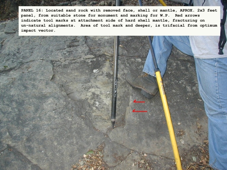

Attached is a photo of the rock with the freshly broken mantle where the "W.P." had been and the 1/4 corner pit.

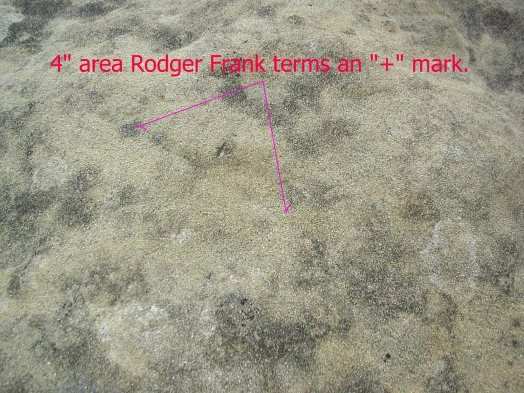

All this because a Orange county contract surveyor has found a mark on a rock he deems an "+" and claims it to be set by the 1891 surveyor who is shown by his notes and those from 1873 to have committed fraud, which is prima in nature in another section of the same township in the same year. What is outrageous is that neither Norway, 1873 or Harrington, 1891 following him describes an "+", as a point set. Most people that see the supposed "+" cannot state it is a manmade mark at all, being very faint resembling a weathered, natural fracture of the surface more than anything. The 1891 notes describing the particular corner, a witness point, also bear exactly the same kinds of inconsistencies that one would expect with the telegraph transcription issue described above.
Following a fire there was a resurvey by the USFS, and this particular surveyor was brought in. Technically his work is quite good, although the owner has indicated that he ignored the instructions of the manual in proportioning in order to fit in better with BLM approves methods. That was information from the 2006 resurvey in consults relating to moving the lines he had documented with a record of survey.

I've uploaded a picture of the "+" mark(?) which is barely visible.

Missed monuments are one thing, but surveys based on bogus notes while the originals have swapped corner descriptions seems a bit more. And, the 1891 resurvey did commit prima facie fraud in the notes created.
There was a compiled platt by the surveyor general, I'll have to check to date. The 1891 survey did not make one.
No owners now are original. Seems like an ethics issue with that "+" "found" that no previous surveyor found or set. I'll be passing your evaluation on to the one holding records to see about patents.

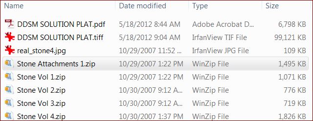

Holy Cow, post: 361406, member: 50 wrote: Many here should remember the great Pipe vs Stone thread several years ago courtesy of Deral Paulk in Oklahoma.
That old thread was titled "Who want's to be a Surveyor?" It started 10/19/2007 and lasted until 10/30/2007. Copied and pasted to MS Word, it created 758 pages.
I go back and study it from time to time:
DDSM:beer:
