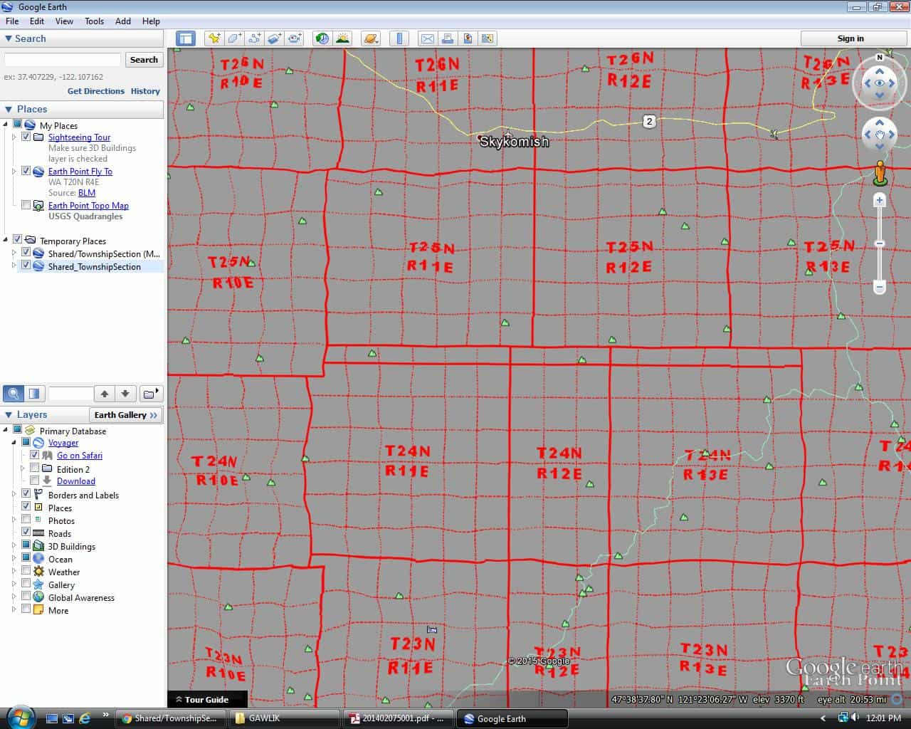

Not sure what the notes say; but I do know one thing: Surveying in the Cascades is tough!
Download the GIS files here: http://www.wsdot.wa.gov/geosvcs/ArcGIS/rest/services/Shared/TownshipSection/MapServer&apos ;">WSDOT shared Files
