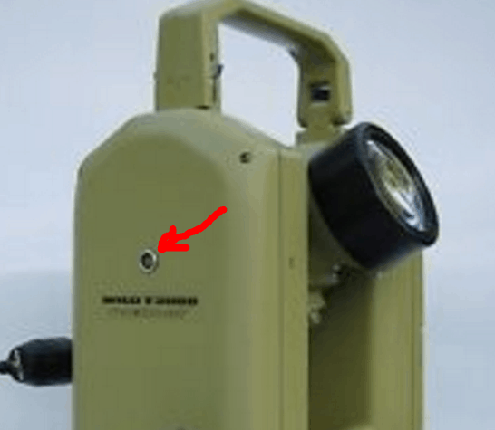

A newbie question...I have a Bosch laser distance measuring device. If I want to take a distance measurement from a theodolite, in my case a Wild T2002, where do I place the base of my Bosch unit? I'm assuming the center or axis of the "telescope" of the theodolite, is that correct?
I realize I'm not going to get it perfect by hand holding it, but I think I can hold it on the side of my unit or just above it and get within 1/8th of an inch accuracy which is all I want or need for my purposes.

The point you are measuring angles and/or distances from should be directly above or below the vertical axis about which the instrument rotates. If you are using a hand-held distance measuring device held over the instrument, then estimate where that axis would come out the top - the most stationary point as you turn it.

If I'm not mistaken, most instruments have a point molded into the case at the axis of the scope, which would be in vertical alignment of the instrument's plumb point. Probably a dimple on the top of the handle too.
The slight offset to the side should never exceed anything of concern... if you're hitting it with a bosch. Just understand the effect of the vertical angle and offset for a glass target.

As jb pointed out, most theodolites have a center mark on the side of the unit.
Your Bosch unit may have selectable settings as to where it measures from. The simple solution would be to confirm your first measurement with a tape.

Hold that end of the laser unit as parallel to the little dot on the side at the centre of the telescope axis as JB set out, in order accurately measuring to the distant object that is within the range set out for the unit.
