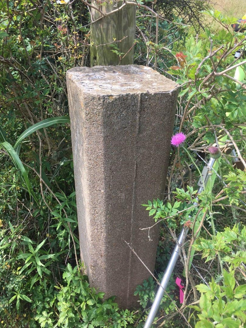

Yes, this one was a ordeal to find. I wasn't sure whether to rent a Schonstedt Concrete Post Detector or not. When you're looking for an 11" x 11" Concrete Post, 48" Up, it takes some real skill to identify the thing.

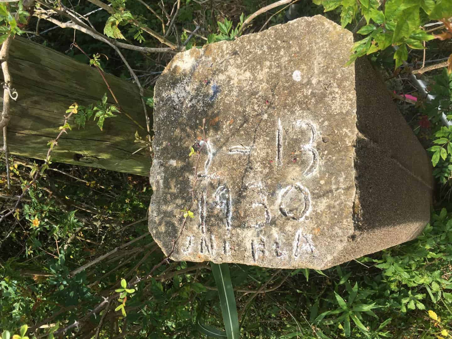

I guess that's why whoever cast that Concrete Post in 1930 actually scratched the date on the top of it:

What, no dimple?

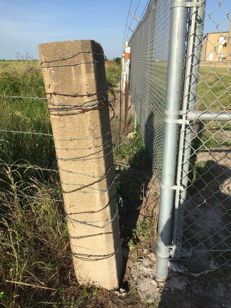

The post was leaning off plumb, so the center of the top would have been NG. I settled for the center of the base at ground level.

There is one tiny problem with setting concrete posts the size of fence posts as boundary markers. Can you divine what it might be?

The concrete thingy is about a foot and a half from the true corner at the center of the chainlink fence corner post.;);)

Yup that concrete do-dad is just a guard stake. It's obvious the fence post is the corner because it's set in concrete. :p

I never do large boundary work, but IMHO whomever strung the barbed wire must have used a D8 for tensioning and yanked the monument off center.

In some soils with low bearing capacity, just the constant tension of normally strung wire will pull a corner post off plumb unless it is braced (which this one wasn't). I'd imagine that the concrete post is at least 48 inches into the ground. but the soil is a silty one.

For those of us (me) who ask silly/stupid questions, what was your methodology in locating the center at the base of the monument assuming that you didn't disturb it?

To locate the monument by the chain link fence post, I just set two spikes on line with the center of the base of the post, one 1.28 ft. distant from the center and one 8.58 ft. distant, located them and calculated the center's position. If anyone ever straightens the post, I'm sure that the center will be found to be in a slightly different position toward the chain link post, but the method I used is sufficient for my purpose, which was to organize the search for another marker about a mile away.
The first concrete post that I originally mentioned above was located from two points offset from the center of the base by 1.45 ft., one nominally West of the base and one North. The post was precast and its dimensions could be easily measured at its top, so the 1.45 ft. was really 1.00 ft. measured from the face of the post at its base plus 0.45 ft. for the distance from face to center.

Would have been much easier if that thistle would have been fully grown.

With tension of the fence and the digging of the hole for the CLFC, the concrete post did not stand a chance to stay in position without having any cross support in place.
Tall concrete posts are a common monument put in place where the land is subject to be filled in.
