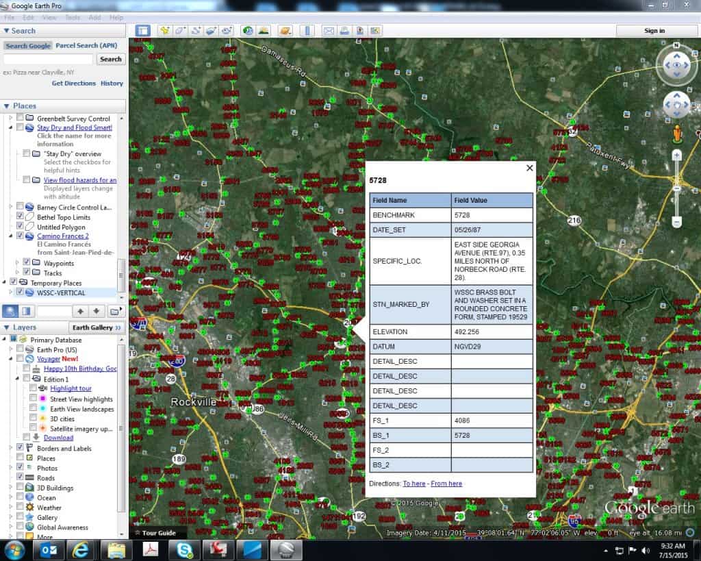

PLS30820, post: 327408, member: 1439 wrote: who publishes NAVD29 values? Not NGS or any County or City in Florida that I have ever seen. Maybe it's different up North.
The https://en.wikipedia.org/wiki/Washington_Suburban_Sanitary_Commission&apos ;">Washington Suburban Sanitary Commission, who run the public water and sewer system in the Maryland suburbs of DC still use 29 rather than try and convert data going back to the 1920's
