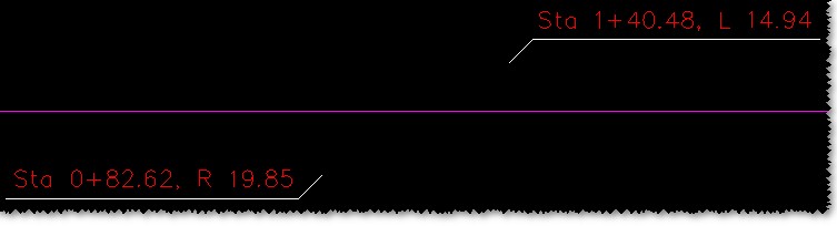

In addition to +/- and/or R/L designations for either the Prefix and/or Suffix, note that you can also include spaces, commas and pretty much anything if your "standard" happens to require something unique:
As it was once quoted to me... "The good thing about 'standards' is that everyone has one." Also, the "Christmas tree light" is actually supposed to be a representation of the nib/tip of a fountain pen:
Posted : October 21, 2016 3:10 pm
Ladd, I tried to add a space to the prefix of the offset label, but it didn't work.
Maybe I need to add a space to the suffix of the station label? I bet that would work.
I realize everybody has different ways of doing things...but I will lay some money down that nobody willingly uses the the default label format that I showed above! It's crud.
The labeling you have shown above would be the perfect default. It gets the idea across right out of the box. If you want to alter the format, you can grab your quill and ink and look around for the settings. But crud by default isn't acceptable.
Label precision...should be two decimal places for foot units and three for metric. Who would argue with that?
Let the anal guy spend his time figuring out how to change the default so he can label stations to the nearest thousandths - not me.
