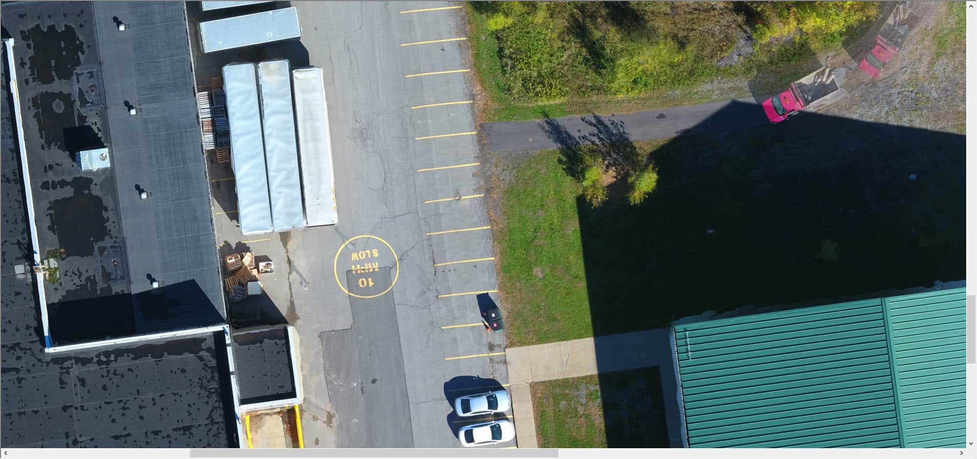

Hello All,
I'm just getting into photogrammetry and I have a few questions regarding image quality. I'm not sure if I'm having issues on the photography end or the processing end. I'm generally happy with the images I have produced except that taller objects such as roof lines, utility poles/lines and towers are distorted.I'm using a DJI Phantom 3 Pro with the Pix4D Capture app to collect the images. I have tried flying at both 350' and 150' altitude with a 90 degree camera angle with similar results. Overlap is 80%. Orthomosiacs are my goal and I've tried both Pix4D and Photoscan. Should I be taking some images at a different camera angle even though my purpose is an orthorecified photo? Should I use a slower flight speed? Any tips you have will be greatly appreciated. I can try to post an image but the file size is huge. Does anyone have any orthophotos created with similar methods that they are willing to share?

Try using a 70å¡ camera angle, also fly a second mission perpendicular the the original flight path.

leegreen, post: 399082, member: 2332 wrote: Try using a 70å¡ camera angle, also fly a second mission perpendicular the the original flight path.
Ok, I guess I should have tried that. I tried to do the "Double Grid Mission" with the Pix4D Capture app but it said I wouldn't have enough battery to complete the mission. I didn't think of doing 2 separate flights perpendicular to each other. I'll try the 70 degree camera angle too. I think I remember you recommending that to someone in another thread but I thought it was more related to making a 3d model rather than an orthomosiac (but I guess I need to make a 3d model in order to make the orthomosiac anyway).

Lee, I did shoot the project again with a 70 degree camera angle and also flew a second flight perpendicular to the first. My results were much better but I'm still having issues as you can see in the attached photos of portions of my orthomosiac. I'm wondering if maybe i'm flying too fast(set in the middle between slow and fast) or if maybe the issue is in my process settings. This is with agisoft photoscan.

GMPLS, post: 401846, member: 8404 wrote: but I'm still having issues as you can see in the attached photos of portions of my orthomosaic.
You're not going to get better results than this without manual intervention currently. The software is trying to compute a true orthophoto and generates a DSM that lacks vector derived building edge lines.. what you want is to manually edit this data to get crisp clear edges.. but that software doesn't exist, yet.
If you want better results you should export the exterior orientations, measure roof lines in a stereo photogrammetric software, generate a new surface model, compute orthophotos, and then generate a new mosaic. It is a multi-step process.. completely separate from your survey work flow. Editing seam lines alone could take several hours.
Good orthophotography is hard, if you're not putting in a dozen hours in for a small site, you're not going to get a good result.

Actually there are many ways to improve this. I'm no export here. But after attending a 2 day Pix4d training session I understand it much better.
Can you show us the Pix4d results report? Much like StarNet there is a wealth of information there that helps us evaluate the data and processing. Pix4d has nearly 3x more user defined settings than StarNet and most choose to only use the predefined settings.
For example; Rolling shutter correction is not on by default in Pix4d. Yet with all the DJI Phantom drones ( except P4 pro busted released) it is a must to turn on, and improve results immensely with a single switch.

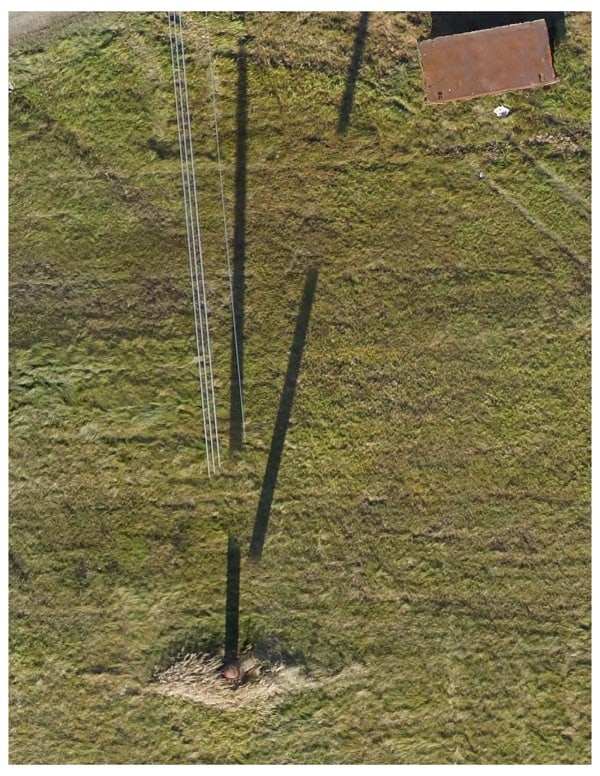

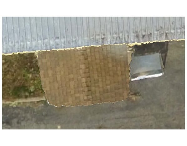

GMPLS, post: 401846, member: 8404 wrote: Lee, I did shoot the project again with a 70 degree camera angle and also flew a second flight perpendicular to the first. My results were much better but I'm still having issues as you can see in the attached photos of portions of my orthomosiac. I'm wondering if maybe i'm flying too fast(set in the middle between slow and fast) or if maybe the issue is in my process settings. This is with agisoft photoscan.
Gregg
Just noticed you're using AgiSoft PhotoScan, not Pix4d.
How many GCP are you using?
I not certain what is wrong in your images.
Image 1: Is the brown asphalt shingle roof not sharp enough (jagged edges)?
Image 2: Is that a utility pole with shadows? Pix4d has settings to adjust the ghosting of images. Not sure about PhotoScan.
It would be interesting to process this same data with Pix4d and compare the results.
Here is othophoto created by Pix4d with a moving vehicle in it that shows ghosting. I can remove the vehicle with Pix4d.
I used 70å¡ camera angle, with one mission.
Posted : December 4, 2016 7:33 am

I'm not using any gcp's yet. I was planning on it but haven't gotten around to it and I didn't figure it would make a difference at this point. Will it help with stitching the photos together (beyond making the results more accurate)?
You are correct in you assessment of my photos.
In the first photo I wasn't happy with the jagged area at the edges of the roof. It really isn't much of an issue for me since it won't be seen at the zoom level I generally use. My intended use is as a background to be used for planning purposes. I would eventually like to be able to create topographic maps though.
The second photo is a utility pole. I would like to get rid of the shadows and it would be nice if the wires looked better but that may be asking too much. How does Pix4d get rid of the ghosting? Is it like a clone tool in photoshop?

The two shadows in your ortho show that you had a significant amount of time between the photos. Looks like two separate flights. This would actually make it easier to remove the shadows with Pix4d. Since you can mask the shadow out of some images, and the actual ground is still visible on the other images. With the image I show below, that is not possible as I have no original ground visible under the shadows. Due to short flight time. One nice part of the shadows is for signs, you can clearly identify a stop sign (2 stop signs in this photo).
