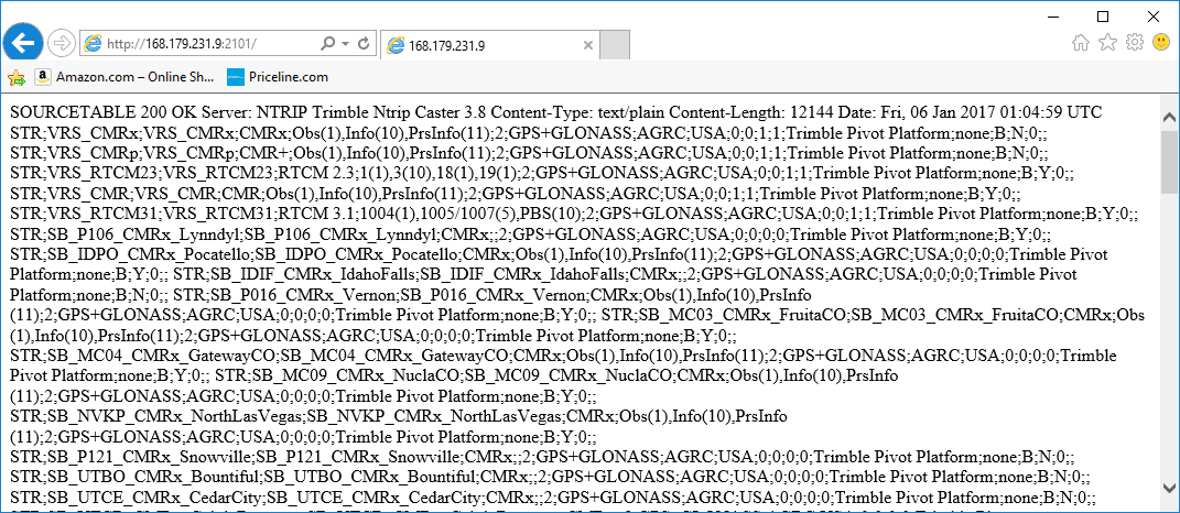

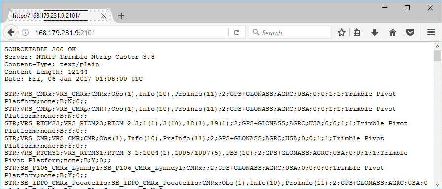

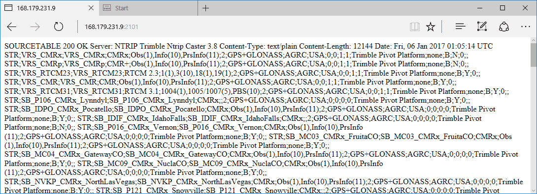

Here are screen-shots of all four browsers:
[INDENT]Chrome (fail):
Edge (success):
Firefox (success):
Internet Explorer (success):
[/INDENT]
Notice that Chrome does not say 'the website can't be found'. Chrome says it sent a invalid (non-standard) response.
