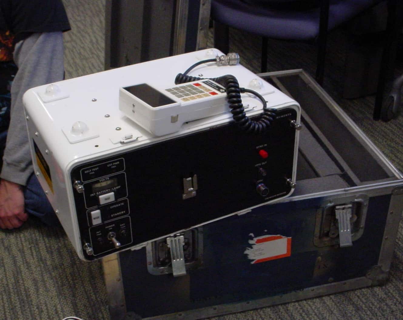

gschrock, post: 443872, member: 556 wrote: It was amazing what could be done with a handful of satellites and some clunky equipment. After almost 2 decades this old TI4100 (below) resurfaced in some university basement. Folks found my name in some old notes and sent it to me around 07. Without the original phase-matched antenna pair I can't do much with it, but in its day it was the cats meow. 4 SV for 4 hours max, cassette storage, and it produced enough heat to warm up the tent (and lunch). The DoD and NGS were among the first users, but plenty of these were used by universities and private entities as well (e.g. oil/gas).
Three decades passed since these came out and this thing makes me feel quite old...
Wild WM101 had tape.
The first Trimble 4000, 5 channel L1, required a Grid portable computer for data recording, before they were called laptops. About $10K extra.
Magnavox was an early player. Codeless, phase data only. Didn't make the cut.
Whatever happened to Allen Osborne Turbo Rogue codeless receivers? You had to subscribe to companies like John Chance for ephemeris data.
The early white-papers had 4 and 5 satellite results.
Anyone remember satellite 8, block 1? Reduced to its quartz clock, you had to set 'disable navigation, survey only' because there were only 4-5 satellites.
In Argentina the only control available was established using US Navy Transit satellites.
Gps satellites were repackaged for the space shuttle. Then it blew up, and they had to revert to Delta-II. That was multi yr setback.
Oh the 80s. Tough time to make a $100K investment in gps.
Posted : August 29, 2017 10:22 am
