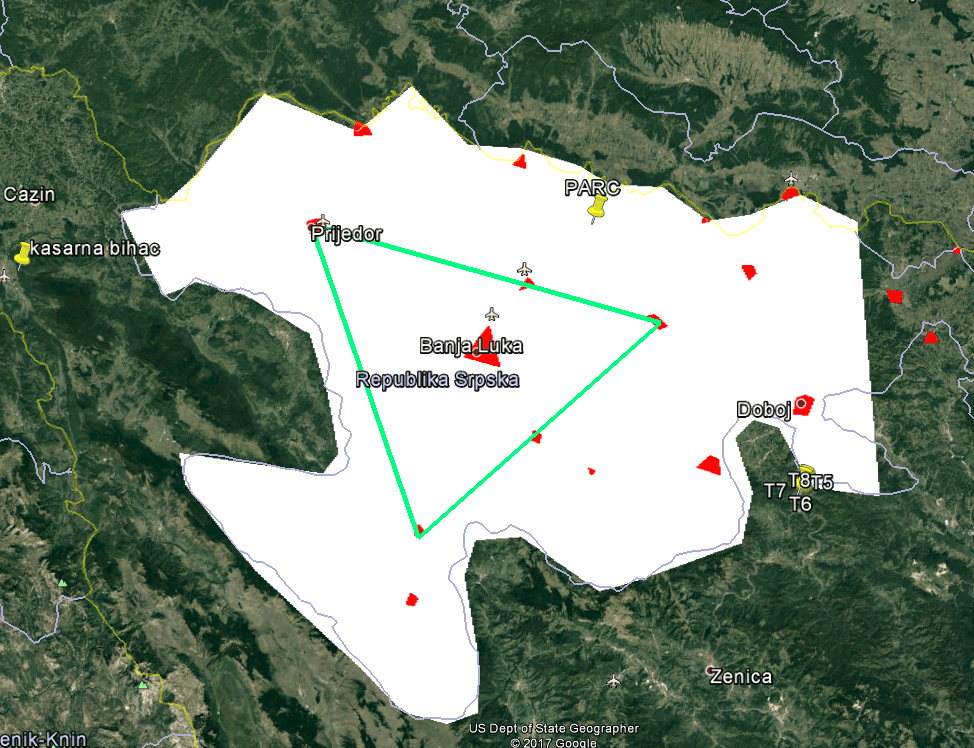

Hi guys and girls 😀
I'm planing to build small CORS network 3- 5 cors stations that will send RTCM corrections trough internet....
Do anybody have hardware / software and any advice? Under is attached image with area that I wish to cover with base stations - approx triangle side length is 70 kilometers...
Thanks in advantage
Best regards
Bojan

it depends on what kind of functionality you want to provide to users

With those distances you need VRS software, not just connect to nearest base,to get good results. $$$
If you just want to provide single base connectivity, SNIP is a good product. www.use-snip.com

?ÿYou can try for beginning with software inside your CORS station, single base solutions.
