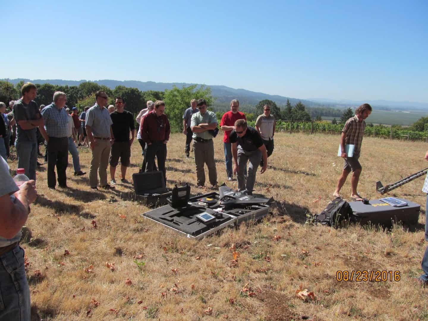

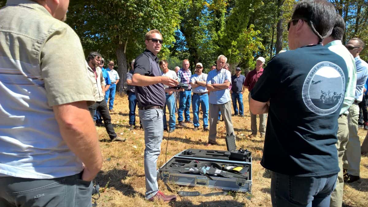

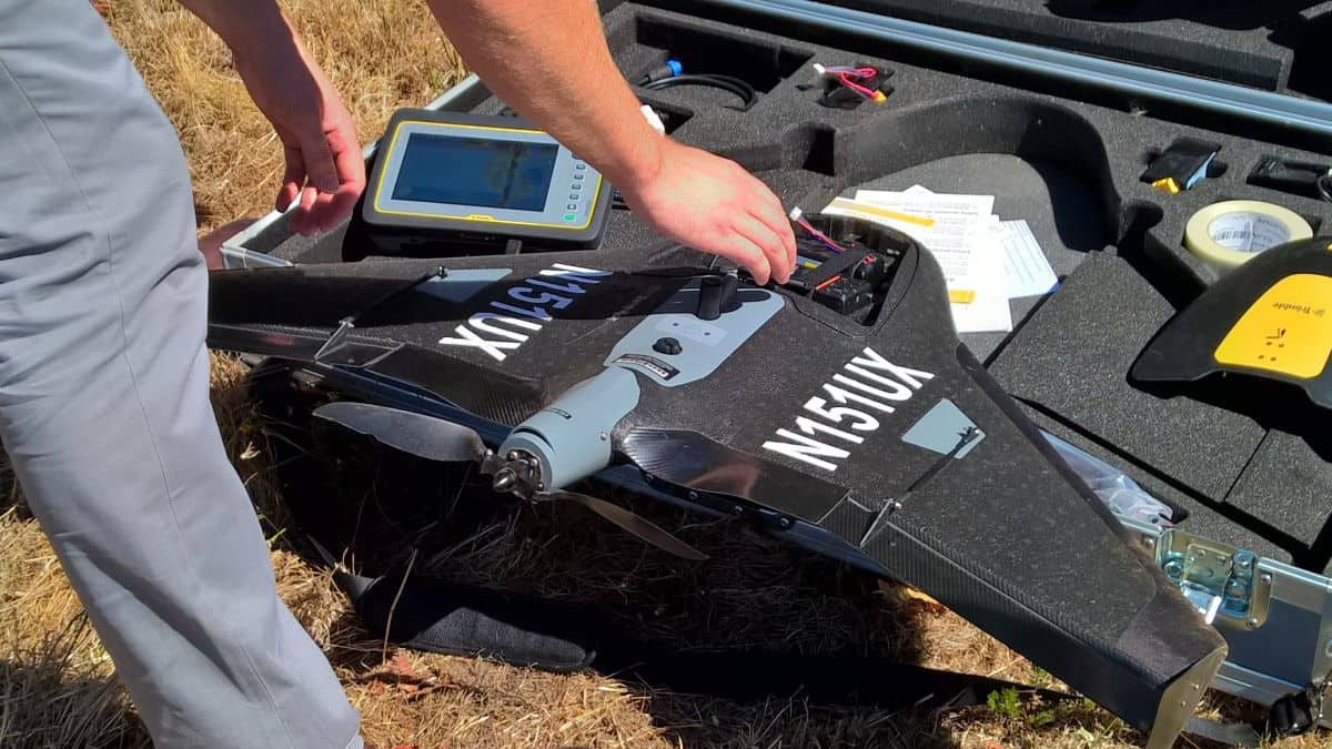

Photos from the fixed-wing demonstration.

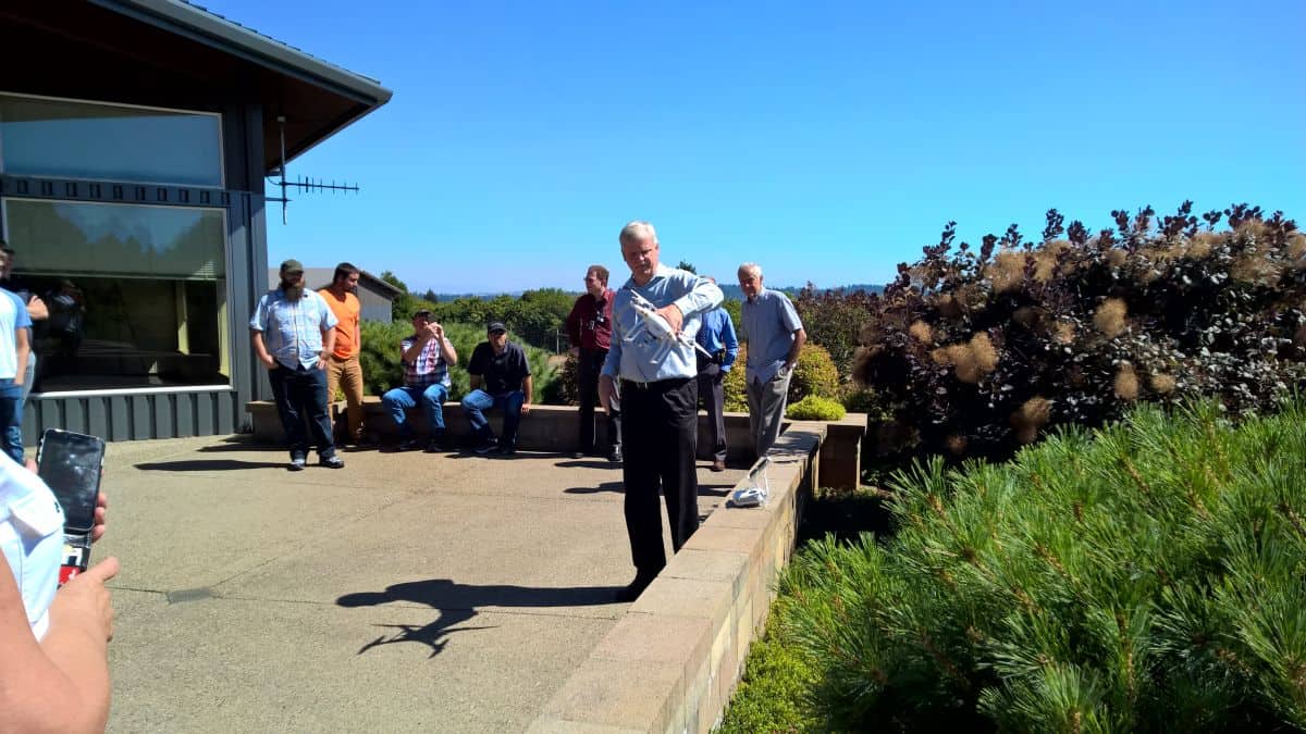

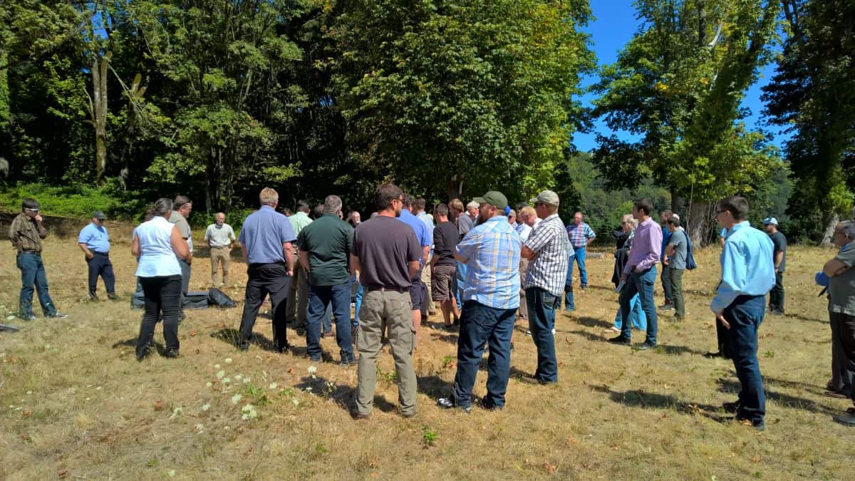

Getting ready for the quadcopter demo.

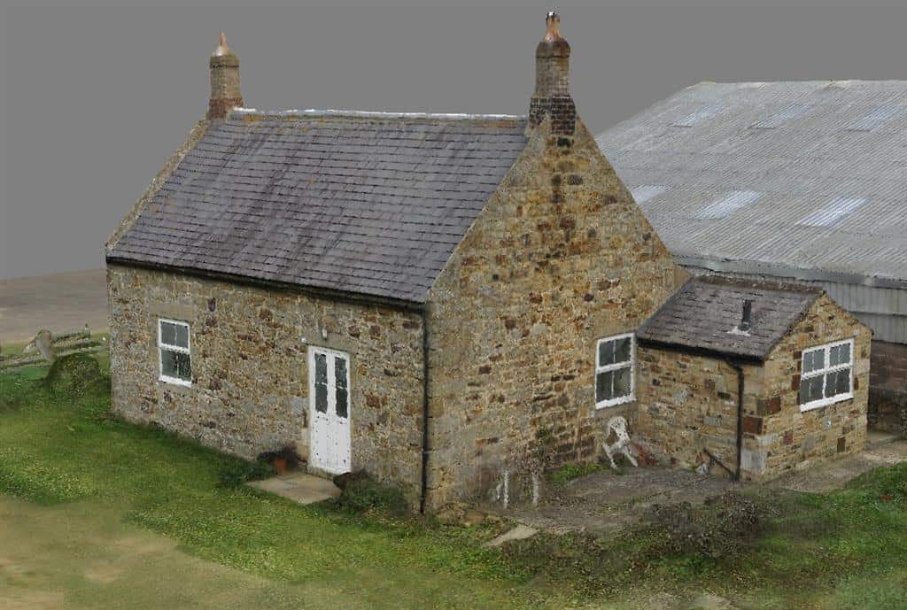

As well as the brands listed by Wendell above, you might like to look at www.questuav.com. Their SUAs are modular, so that you can swap different bodies for different payload configurations. Flight time for a 500 metre radius survey at 350 foot is about 20 minutes giving a 3cm. GSD. With proper ground control points that equates to +/- 2cm. on hard surfaces, variable on vegetation. (Depends on the filtering ability of the processing package and the density of the vegetation.) Maximum time I've had out of one set of batteries is 45 minutes, but there was quite a bit of power still to spare.
Camera size: it is important in that it controls the GSD for a given height. True, you can fly lower to achieve the required GSD with a smaller camera, but that means many more photographs and a slower flying speed to maintain the required forward overlap (difficult on a fixed wing and more flights on a rotary). If the lighting quality changes over the time of several flights then the results may suffer - orthophotos especially may be less than sparkling. We use a Sony A6000 which is 24MP - a job of 1500 photos NEEDS a really big computer to process efficiently. Shutter speed needs to suit the flying speed. Generally around 1000th second should be adequate but the lens need to be stopped down for good definition, somewhere around f6.3 to f8. Opening it right out leads to poor definition and then poor pixel matching in the processing.
The attached image shows the result of photography from 350 foot, with additional building face detail merged from a few ground photographs (you can see the line on the grass where the air and ground images change)

chris mills, post: 387944, member: 6244 wrote: with additional building face detail merged from a few ground photographs
What's the thing that looks like a dog running through the wall beneath the window to the right of the door?
Posted : August 26, 2016 9:36 pm
Jim Frame, post: 388265, member: 10 wrote: What's the thing that looks like a dog running through the wall
I'm thinking it's a plastic lawn chair leaned against the wall.
Posted : August 26, 2016 11:35 pm
Posts: 7465
Mark Mayer, post: 388273, member: 424 wrote: I'm thinking it's a plastic lawn chair leaned against the wall.
I see that now, and agree. But I rather liked the image of a dog or calf jumping through the wall.
