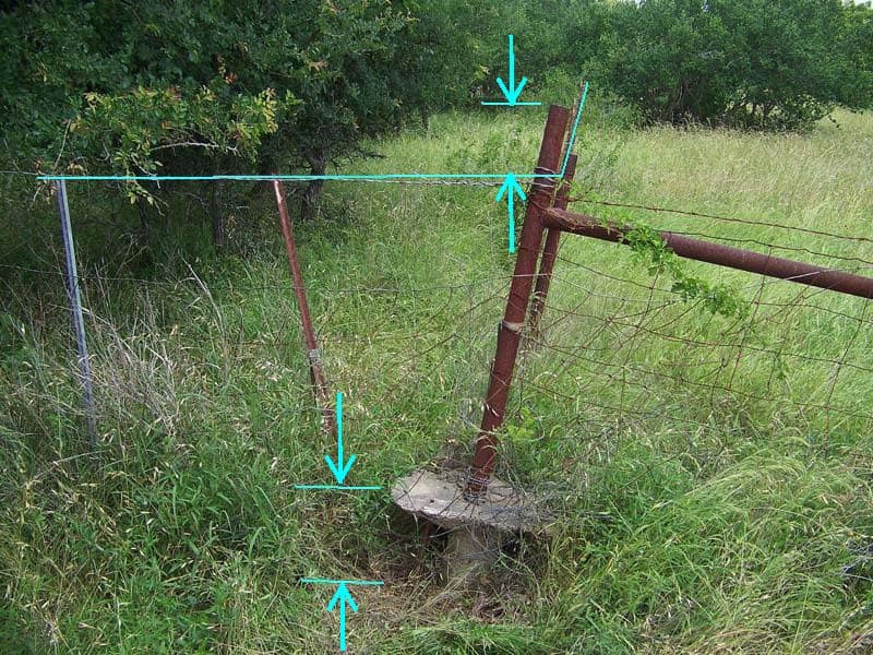

Well, if a surveyor finds what appears to be a survey marker grossly out of position, would a reasonable surveyor just dust off his or her hands and say "that's it!" or would he or she set about determining what, if any, evidence suggests that it is not in fact either (a) a random piece of junk stabbed in by parties unknown or (b) something that was probably actually placed in that position by the original survey? If the latter, what technical lines of evidence would a resonable surveyor want to consider?
BTW anyone who wants to complain that the photos I posted at the beginning of the thread didn't clearly indicate that the rod was disturbed might want to have another look:

Kent McMillan, post: 371720, member: 3 wrote: if a surveyor finds what appears to be a survey marker grossly out of position
This would've been useful information in the OP....
From the OP:
Kent McMillan, post: 371538, member: 3 wrote: Apparently, the fence post (what in some states would be known as the "original" fence corner) was set in concrete in a hole beside the rebar and the concrete ended up encasing the top of the rod. The rebar is the same pattern as other 1/2-inch iron rods found marking other corners of the tract that the public records indicate were placed in 1983. The survey was made before the conveyance and the land was then conveyed using a metes and bounds description prepared by the 1983 surveyor calling for this marker at the corner.
Is there something here; that would lead me to believe that you had not found a monument "grossly" out of position and that you were now left with determining whether the top or bottom of a slightly "disturbed" monument was the best position to hold?
