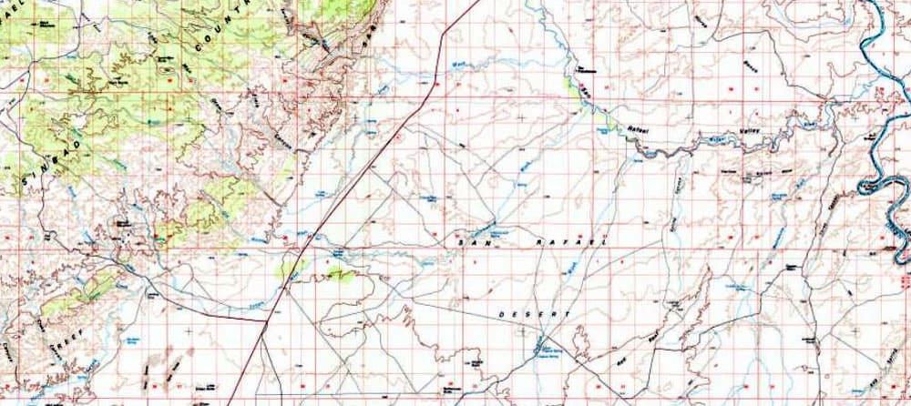

And San Rafael Desert Quadrangle in Utah also looks pretty typical:

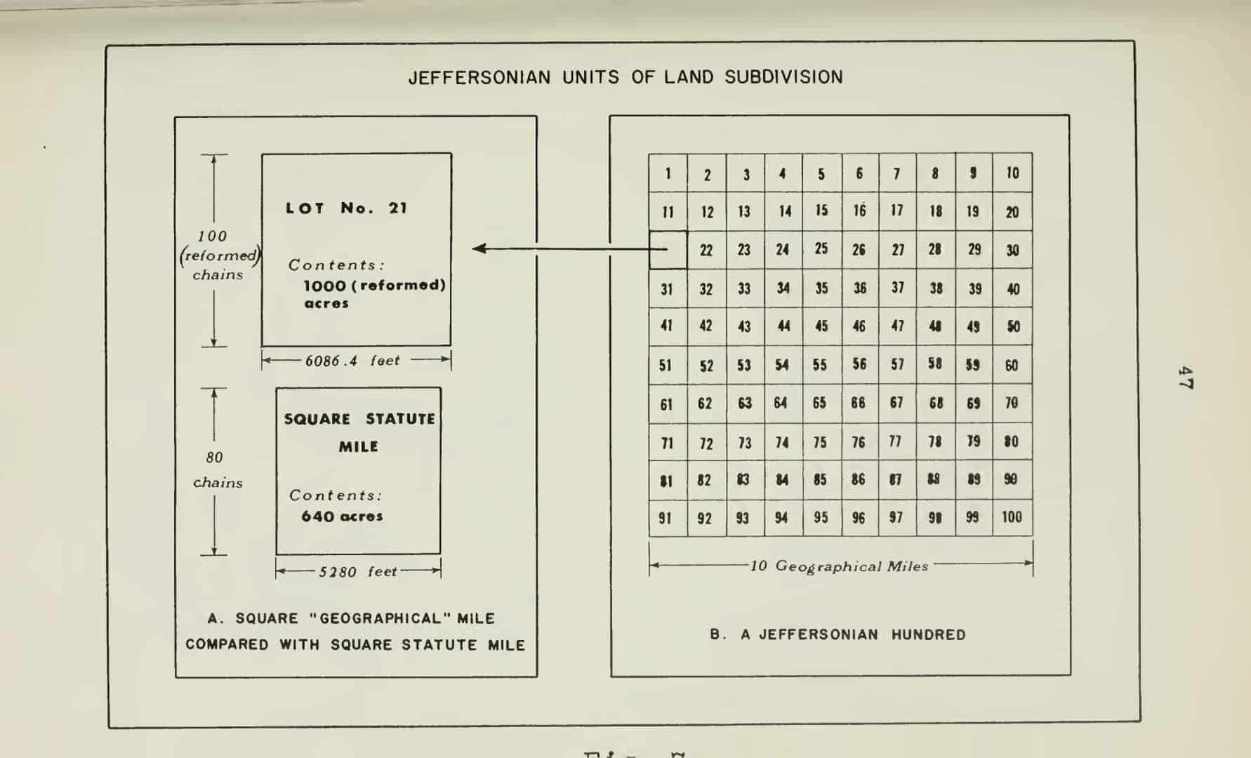

Many folks give Thomas Jefferson sole credit for developing the PLSS system. In general terms, his vision of a rectangular survey system was adopted. However, if he had not assumed the post of Minister to France when his "plan" was finally adopted, the PLSS may have looked quite different.
The Continental Congress in December 1783 instructed a committee headed by Thomas Jefferson to prepare a report on dispositions of public lands and other issues. The committee's report (including a recommendation for a rectangular method of dividing the land) was submitted to Congress and approved in April 1784.
Jefferson's committee had proposed a decimal-based system where the land was first divided into a Jeffersonian Hundred. The Hundred was 10 geographic miles square and composed of 100 lots, each being 1 geographic mile square. The lots were numbered starting at the northwest corner of the Hundred and increased to the east. The second tier was number from west to east as lots 11 through 20 with this pattern repeated for the remaining 8 tiers (Lot 100 was in the southeast corner of the Hundred). The area of each lot (1 geographic mile square) was to be 1000 (reformed) acres (850.4 acres), with lineal dimensions of 100 (reformed) chains equaling 1 geographic mile.
Attribution: "Beginnings of the American Rectangular Land System", William D. Pattison, Univ. of Chicago Press, 1957, page 47.
On March 4, 1785 with Jefferson in France, Congress submitted the Jefferson committee's report to a new committee headed by William Grayson. The new committee scraped the decimal system favored by Jefferson, who was keen to have the land system mimic his desire for a decimal-based coinage system. Grayson's committee submitted the revised report in April and on May 20, Congress passed the Land Ordinance Act of 1785.
