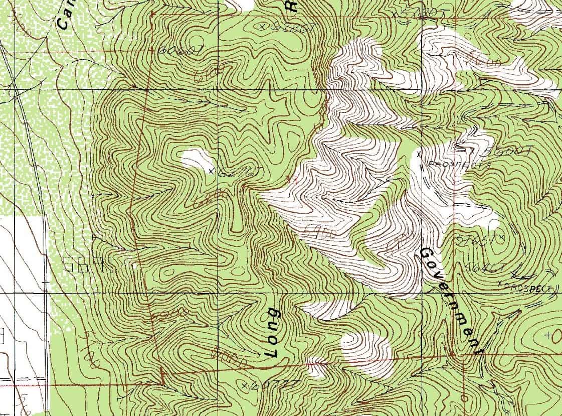

ridge
(@ridge)
Posts: 2701
OK
Here is the GLO plat
http://www.highterra.com/pdf/ut260120s0010w0-c0841b.pdf
Nice one, Section 33.
Posted : December 23, 2016 2:32 pm

Private Sale Patent in 1953
State Land on North Boundary, Uncle Sugar (Imperial Entanglements) on the South Boundary.
Only about 1000 feet of relief.
Once you figure WHAT to do, then it will be a fun job NEXT SPRING!
Piece of cake, right Leon?
Posted : December 23, 2016 3:15 pm

Bear in mind that the SWå? of Section 33 doesn't HAVE 160(ish) acres in it.
I haven't run the numbers on the Plat (see Leon's link above).
Fun and Games in the Great Basin.
Posted : December 23, 2016 3:53 pm
Norm
 Norm
(@norm)
Posts: 1331
Based on the plat I'll back off the W 60 acres according to Govt survey although it could be a solution. There are no government lots in the SW quarter. Does the plat assume 160 Ac then? I can't tell. Whatever is done I doubt if I would argue with it. So the idea to have the owners sign off on it will protect the owners and the surveyor.
I just looked at the HI and Patent, "they" appear to treat the SWå? as 160 acres.
