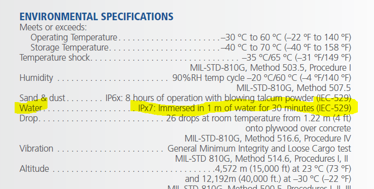

It can handle rain, just don't box it up wet, let it air dry thoroughly.
Posted : June 2, 2017 10:21 am
lee-d
(@lee-d)
Posts: 2382
TSC3 specs:

Out here in the Pacific NW we ( by "we" I mean everybody in the business north of San Francisco) routinely work in the rain. All day some days. Many days every winter. As Lee said everything will be fine as long as you dry it thoroughly overnight. Towel the excess wet off as soon as you get back to the office and leave it out of the box to air dry until you need it the next day. Same with the carrying case.
