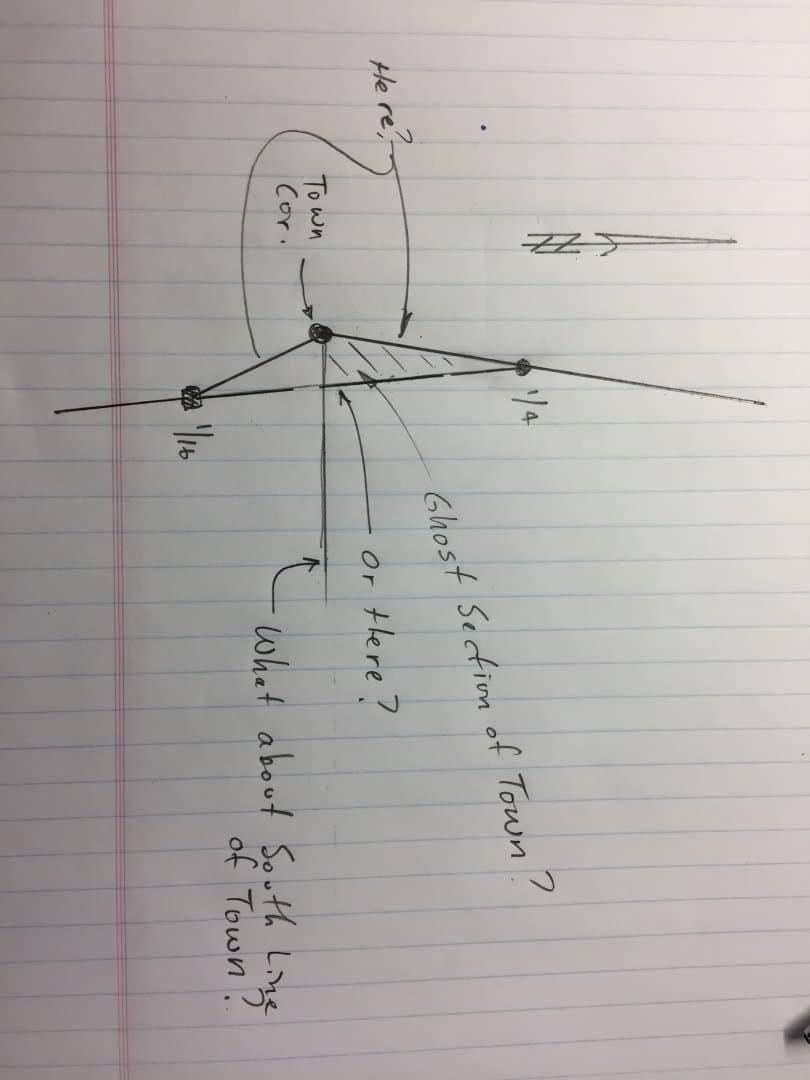

While doing a survey for Smith we recovered an old 1917 corner for a small rural town (really a subdivision of 30 some lots more than a town).
The southwest corner of the town looks like it was extended from the section line along the east line of the NE1/4 Section which is the west line of the town then from the E1/4 of section 20 to the south for 360' and the corner was monumented. Since there is a strong angle in the east line of Section 20 at the 1/4 corner this pushed the southwest corner about 15 feet into Section 20 instead of it all being in Section 21.
So that brings up some typical issues, the description for the town is all in 21, the description for smith includes the SE1/4 of Section 20 which creates some conflicts; do you try to claim the property which includes a 12' alley and some slivers of a few lots, do you kink the section line to the monument that has been there for 100 years or do you create a jog in the property line? The S1/16 is also set mid point between the monuments at the E1/4 and SE corner of Sec.20. In this area of the town it's just pasture there are no structures although there are houses to the north.

Section 5-9 of the 2009 BLM manual: "In conducting a resurvey, care must be exercised to avoid disturbing satisfactory local conditions such as roads, fences, or other improvements marking subdivision of section lines and that may correctly define the extent of established bona fide property rights."
Personally if I thought that 4" pipe had been there for 100 years, undisturbed, I'd probably hold it, but of course I don't have all the facts. What vintage are the monuments at the 1/4 corner & section corner? Any chance they've been remonumented since 1917, or worse yet proportioned back in after being lost?

Mixing surveying and law sometimes creates results that may be difficult to disseminate. The evidence indicates there is no question as to where the SW Town boundary corner is located. Whether or not a portion of 'town' that actually lies in section 20 has clear and marketable title is a question probably best answered by others. A surveyor's discovery and location of a boundary doesn't necessarily imply any warranty of title.
"Just the facts, ma'am." As Sgt. Joe Friday put it so many years ago.
Posted : January 18, 2017 12:06 pm
There is no conflict in Title. Smith's boundary is the Section line, as is Jones's and the Town's. The developer of the town did not attempt to sell someone else's property but they did (maybe?) attempt to establish the Section line.
The key question of fact of fact is where is the section line located. Legally it is straight, in fact, it may not be perfectly straight, as a practical matter. Straight is a relative quantity, a legal quantity, not a mathematical quantity.
I can't say either way but a pipe (if it is prominent, visible, and known to the property owners) that has been there 100 years is pretty strong evidence of acquiescence in an established Section line.
Posted : January 18, 2017 12:15 pm
paden cash, post: 409791, member: 20 wrote: Mixing surveying and law sometimes creates results that may be difficult to disseminate. The evidence indicates there is no question as to where the SW Town boundary corner is located. Whether or not a portion of 'town' that actually lies in section 20 has clear and marketable title is a question probably best answered by others. A surveyor's discovery and location of a boundary doesn't necessarily imply any warranty of title.
I don't disagree with this. The pipe may be evidence that the Town overlaps into the adjoining Section. If that is the case then the overlapping portion, perhaps we can call it the Ghost Triangle of the Town, is not owned by the Lot owner in the Town, it is owned by Smith.

Dave Karoly, post: 409794, member: 94 wrote: I don't disagree with this. The pipe may be evidence that the Town overlaps into the adjoining Section. If that is the case then the overlapping portion, perhaps we can call it the Ghost Triangle of the Town, is not owned by the Lot owner in the Town, it is owned by Smith.
I think I understand the paradox here. But just for the sake of argument; you state above the "Ghost Triangle" is not part of the estate that lies in "Town", but owned by Smith. Can a surveyor really legally determine ownership?
Posted : January 18, 2017 12:24 pm
Posted : January 18, 2017 12:25 pm
paden cash, post: 409798, member: 20 wrote: I think I understand the paradox here. But just for the sake of argument; you state above the "Ghost Triangle" is not part of the estate that lies in "Town", but owned by Smith. Can a surveyor really legally determine ownership?
I don't think a Surveyor should determine who holds Title, leave that to the Title Insurance Company.
However I do think a Surveyor can determine a reasonable opinion as to where a boundary is located by the best evidence available. In cases like this, however, I acknowledge that a Judge may disagree with me so it would be best for the Town and Smith to get together and agree or Smith can choose to leave sleeping dogs lie.

People get hung up on rules, most of these times these rules only exist in their own minds. In this case, the rule in some peoples minds is the section line has to be straight for a 1/2 mile. Is there a lot of case law to back this up? Maybe but I doubt it. Is there a lot of case law that says monuments and occupation govern? I say yes.
I think is this case people look at the corner being over 15' off and say thats too much. Keep in mind there is no distance a corner is out of any give position before you use it or reject it. In some cases a corner might be out of postiion by over 100 feet and is should still be used and there might be cases where a corner is off only a 0.10' and it should be rejected. By out of position I mean where the math says it should be.
In my area, a survey that was done a 100 years ago, they may or may not have even go south a 1/2 mile to locate the next corner. They may have just measured down and set the pin in the fence or the fence got built to the pin. This example is very common in my area and most times I would try and use the pins.

Who surveyed the town in and what was the reason for establishment? Was it the GLO, Railroad, Mining Company...... Does the plat for the town close? We have had a few of these almost exact situations come up in the last few years and as usual, it all depends and varies on a case by case basis.
Posted : January 18, 2017 5:14 pm
How did you determine the brg going north from the 1/4 cor?
How did you determine the brg going south from the 1/4 cor?
Posted : January 18, 2017 5:37 pm
Posts: 10689
Nate The Surveyor, post: 409869, member: 291 wrote: How did you determine the brg going north from the 1/4 cor?
The section has monuments at all eight corners
