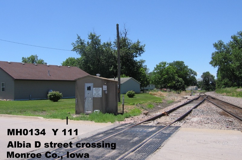

I recently https://surveyorconnect.com/community/posts/452296/&apos ;">posted a picture of a setup where I needed a tripod to hold up one leg of another tripod, in order to get the antenna nicely above the surroundings.
Another way to do that would be to fabricate a longer tripod leg, say by taking an 8 ft board and using a router to cut the groove on each side. If I did that, would a common pine or fir board be be stable enough for a few hours?
I have potential target for a GPS on Bench Mark program session, shown in the picture below, that needs a tall setup. It seems likely there may be metal in the walls of the building, and certainly equipment inside. I expect I could get away with being close to the RR because it is at a public crossing. That could use a tall tripod, say by making three of those longer legs, in order to get above an obstacle. Stepladder for setting up the tribrach. At that height, the horizontal centering might not be too great, but vertical is what is critical.
Or should I get a friend with a lathe to thread fittings for a piece of EMT conduit so I could have a fixed-height (say 2.5 meter) pole? I'd have to acquire a good rod level, of course. How do you get an 8+ ft pole that is top-heavy with an antenna to remain vertical for several hours?
Since this is a hobby activity, the budget is "as little as possible." Manufactured poles might break the budget.
Bench mark target:

I am interested in whatever solution you come up with. I have run into similar situations where I tried to use a taller rod but it just wasn't stable enough for the given wind conditions. I thought about night observations during calmer winds. But I was still uncomfortable with the setup. I also thought about a taller tripod or bipod to provide stability higher up the rod.
It also occurs to me if you are only after vertical, why not set a nail away from that building where you have clear skies but within one level setup distance from the station?

BushAxe, post: 453371, member: 11897 wrote: why not set a nail away from that building where you have clear skies but within one level setup distance from the station?
That would be the easy way to make use of the disk for your own project, but there's no way to tell the OPUS Share process about such operations so you end up with an invalid horiz position in the data base.
As far as I can tell the GPS on BM program has to have the antenna over the mark.
I had thought about such methods for a vertically mounted disk, where the ARP could be set to the same height as the mark by using the level to direct the adjustment of the antenna tripod and tribrach. But if you tie it to the PID and then note that it isn't over it, I doubt NGS would use the data for their model checking. Is there anything written about doing this for GPS on BM?
