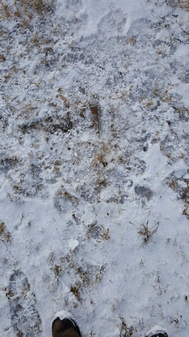

I got a call to do some work in Section 27, it was not a Section I had needed when I was in the area this summer, I did have the SE, NE and NW corners because of some other work in surrounding sections. This left the SW corner to be found, but when looking for these old surveys there can easily be a 50' radius to search, with much snow it can be very frustrating to say the least.
Were my office is there is a good 1' of hard packed snow, but I was told it was mostly open ground on the job site. As I was driving there, there was deep snow almost the entire way until just before I got to the site and sure enough it was mostly bare ground, so I lucked out. Sure enough with some scrapping, some poking I hit the monument:

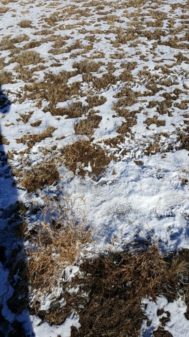

This one even has a remnant of a pit 5.5' northeast of the corner, it's filled with ice now, it even shows up on the newest google photo
the ice filled circle is the old pit

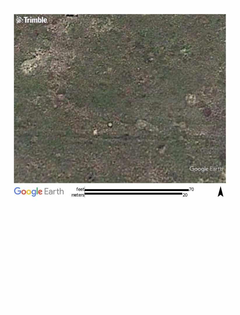

You are saying that the pit itself is visible in Google Earth?!

yes, it's very visible, the photo is 2014, the pit is a nice looking circle.

here is the google photo, the pit is the little white circle, the white irregular shape to the southwest of the circle may have also been a pit, but it is a prairie dog hole now. They are 11' apart and the stone sits on line and midpoint between them.

Looks like you had a pretty good location for starting your search. Nice that you were on a location that actually had exposure to the winter sun.

I lucked out, it was an area that got missed when everyone else was getting snow, the night after I left it got 8" of blowing and drifting snow from what I hear. Hard to say if I would have found it under those conditions, like to think I would have 😉

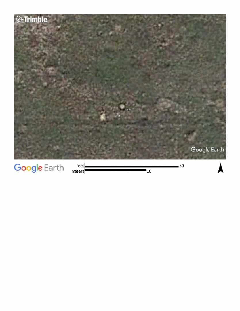

it's amazing how clear the google photos are sometimes, this is it zoomed in, with the stone and the pit coordinate plotted on it. The points come in a few feet southeast of the photo positions. Not too surprising.

Thats really cool.

I will file a corner record for it, ties to nearby corners, I did not disturb the stone, it is imbedded in solid ice which is probably 4 feet deep at this point, trying to dig it up now would only destroy it.
Once the corner record is filed no one should have any issue finding it again. According to the landowner it's looked just like that for 60+ years now.

The landowner in question is in his late 80's (I'm guessing), he said he went with his dad to show a surveyor that rock 60 years ago. He said his dad pointed it out to the surveyor and promptly kicked him off his land. Considering the time frame, it may have been the crews looking for corners to put on quad sheets, this one shows up as an X. Since it's been flush for 60 years I'm glad its still showing at all; record is a 20x16x4. I measure the top to be 13x5 so there may be almost 2 feet in the ground. That will have to wait till spring, if I'm back there I will take another look at it.
