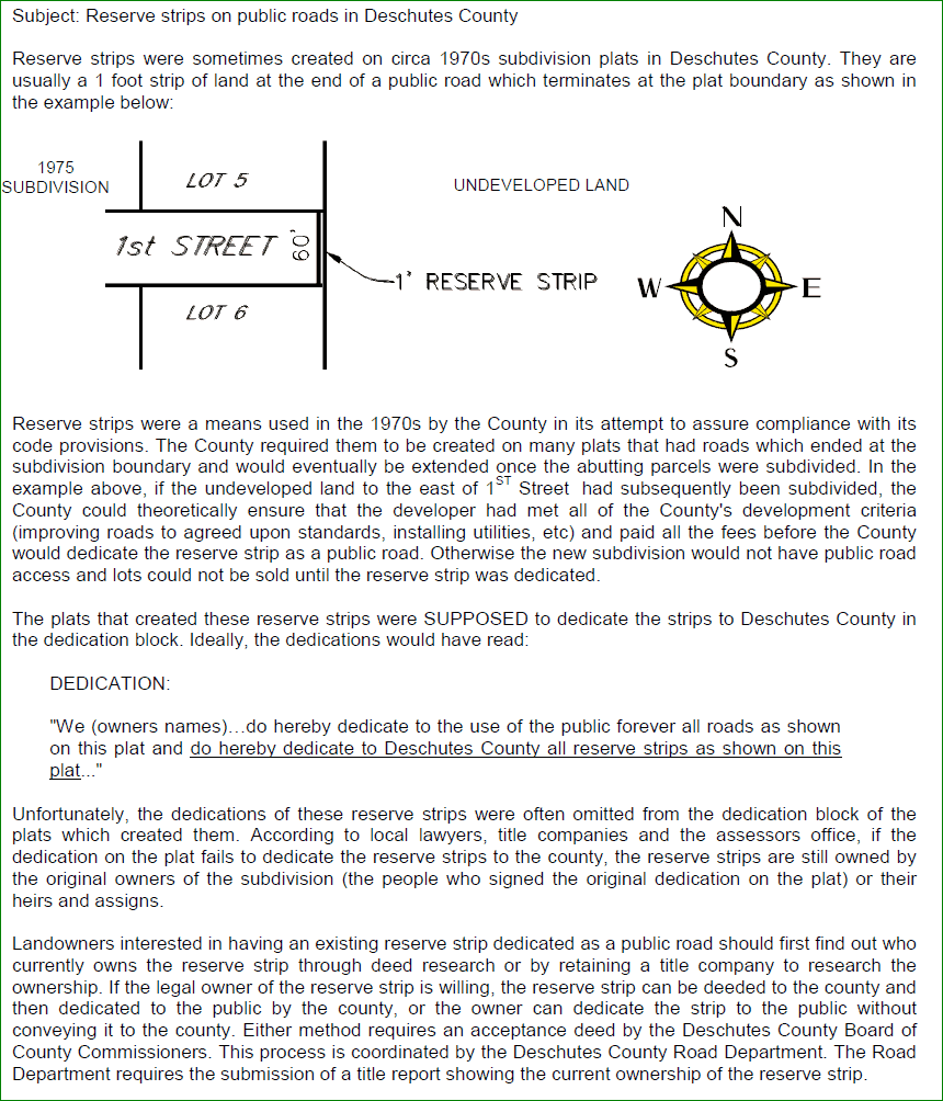

Here is an explanation of reserve strips as they exist in our area-

This is what they use in Medford Oregon. Problem is if the street is ever vacated it leaves a 1' strip of land that does not inure back to the abutting lot owners.

Jp7191, post: 438907, member: 1617 wrote: Problem is if the street is ever vacated it leaves a 1' strip of land that does not inure back to the abutting lot owners.
Jp
Exactly Jon. These "spite strips" or "reserve strips" or "street plugs" (more like b*** plugs) are the ill-conceived ill managed white elephant gifts that keep on giving. We had one notoriously sleazy developer from the 70s rear his ugly head 10 years ago when it was discovered he still owned one of these and decided to hold a nice couple hostage to the tune of 10k for 60 sq.ft. of land so they could readily access their abutting property. They found a different route after going round and round with this unscrupulous S.O.B. of a poltroon. So he still sits on it bidding his time...

That's why I drafted up the explanation above - to explain what the situation was to citizens who got sucker punched with the reality of a reserve strip and how they can try to resolve it. So like it or not, that's how it is handled where I work. In the 35 other Oregon Counties it might be approached differently. Likely.
