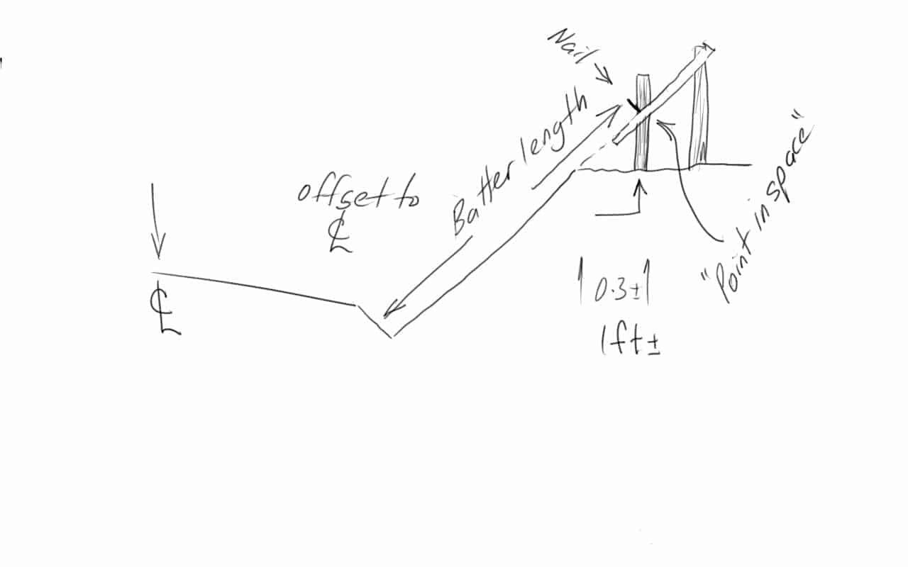

Rankin_File, post: 330268, member: 101 wrote: Just to make sure you understand- there should be NO slope distances on anything- everything should be horizontal distances and vertical distances.
Over here we'd do just that. Slope stake batters.
Maybe I've lost something in interpretation?
Party Chief threw in some phrases I'd guess at.
I'm assuming you have a fixed slope cut/ batter grade but the part where pond meets ground is rolled over" or a series of short grades resembling an arc.
Outside of machine control, I get asked to stake the place where the cut slope intersects natural surface.
I've found most operators will cut the pond/ embankment on grade, then come back later and "trim" the top of the batter (as we call it) to soften the effect or for whatever reason.
I was bought up on batter profiles.
Our roadworks software was quite neat and calculated a "point in space" that was an extension of the cut batter (excavation line on grade) back into thin air.
It calculated a point on that line that was about 0.5 metres above the ground.
We'd drive a stake there (stout peg 2" thick, 1" wide about 4' long) and Mark that elevation on the side of stake.
We'd drive a similar stake about 2.5 - 3 feet behind it and then nail a straight piece of timber to both stakes at correct grade such that it was on the previously marked front stake.
The resulting s
Posted : August 15, 2015 3:43 am
Well what a bummer. I accidentally hit post and then the time to edit expired just as I hit post and all was lost.
Posted : August 15, 2015 4:04 am
Part 2 with apologies.
The profile would have the chainage, length of batter (from nail to change of grade, be it next bench in large cuts or the table drain or toe of cut/ batter.
Often we'd write offset to road centre.
The profile pointed to centreline.
We'd drive a small peg (dumpy) at base of profile for future reference if needed, which was rare.
Fills treated same, but placed such that the profile board was about 5' above ground = eye heightå±.
Only issue with fills were odd boulder or similar rolling over batter and knocking the profile.
Then it was easy check from dumpy previously set.
100's of kms road were built using this method.
Anything over a 3-4' cut saw a profile erected.
25 years of that was enough for me and I'm thankful I don't get much call on that now.
Machine control has taken on, thankfully.
I'll try and post a sketch from my tablet.
Posted : August 15, 2015 4:40 am
