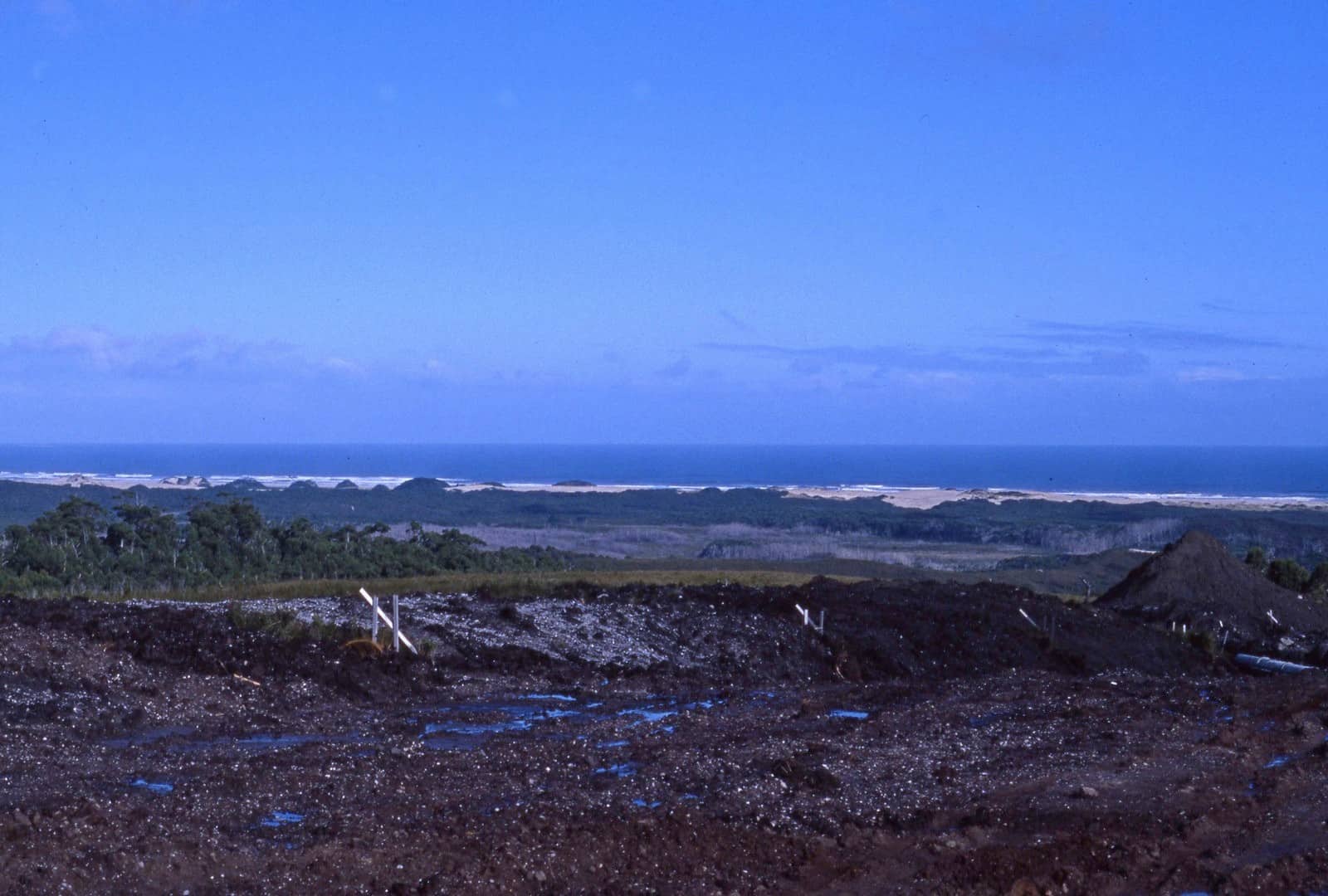

A blast from the past - Public Works Department (Tasmania) style.
These are typical profiles, but they come into their own on large fills and cuts.
West Coast Tasmania - Professor Range
Posted : August 27, 2015 6:32 pm

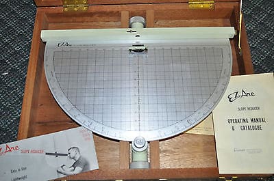

Interesting. Around here medium cut slopes were chased down the hillside using a 6' folding rule and a hand level. Taller slopes could be checked with an "Easy-Arc" or "Rhoades Arc" on a staff and a cloth tape.

partychief3, post: 334034, member: 9053 wrote: Seeing that at one time my place on the totem pole is being the guy who carries all that lumber on remote sites, Good on ya mate.:beer:
You're spot on.
Interestingly this was in a remote area where we mostly walked.
Well at least where construction hadn't got there.
We had one of the very first Suzuki 4WD "biscuit boxes ". Great little thing, noisy but worked. Most times.
Still wouldn't climb the Professor Range though.
One day we got our station wagon 2WD bogged to the door sills.
Only available toe was the grader. That wasn't made for off road travel and soon bogged.
Reinforcements arrived in shape of articulated loader. Obviously not made for off road.
We decided to high tail it and not wait for the heavy artillery.
The local works supervisor was not known for eloquence.
(He once said he wasn't a %@## supermarket when we asked if he had something.)
He wasn't our boss, but it was his machinery.
A D something finished the job.
We weren't popular!
All about getting truckloads of stakes on site to make profiles!
