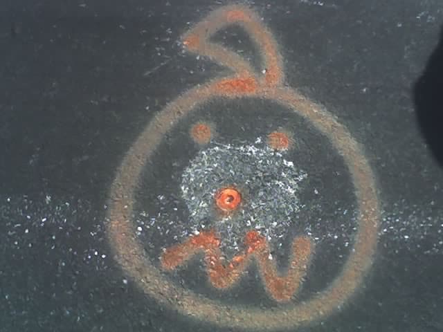

I once got bored of making my usual orange triangle around my nail in the street, so I grabbed a large, nice shaped leaf off the ground (it was in the fall) and laid it down over the nail. I then sprayed over the leaf and beyond about an inch around, then lifted the leaf leaving a nice leaf shape around the nail. It was so neat that I never did it again since.
