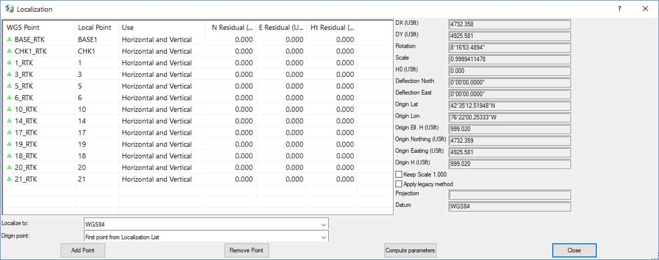

leegreen
(@leegreen)
Posts: 2186

This is what properly performed "In House Site Calibration" should look.
