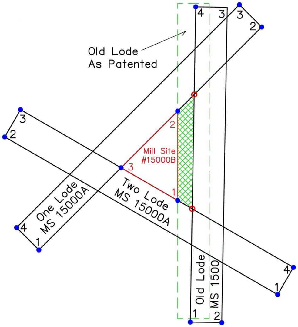

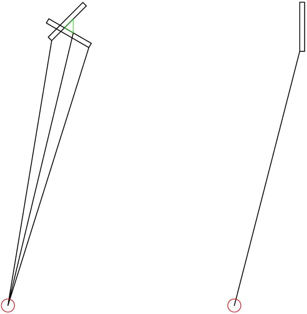

Let me further flesh out how the Colorado Surveyor General and the various U.S. Deputy Mineral Surveyors implemented the Binger Policy. By that, I am attributing the policy to the Hon. Commissioner of the General Land Office whose stamped signature was placed on the letter, Binger Hermann. The term may also be used as the verb, to binger which has a connotation similar to the acronym FUBAR!

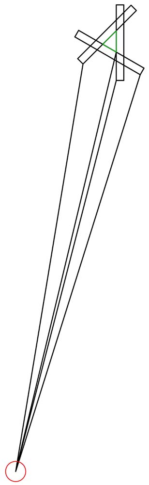

I've mentioned before that the policy was like playing the child's game, Pin the Tail on the Donkey. The mineral surveyor would go about his field work, accurately measuring the lines of the survey and setting monuments. For any prior official survey that was believed to be in conflict, the mineral surveyor would survey the positions of the PLSS corner(s) and/or USLMs that the previous official surveys were connected to. He would then turn on his computer, load his ACAD ver. 1 and draw up the record dimensions and PLSS connection for each senior conflicting claim. He would then snap the PLSS connection to the position he determined by his field survey for the PLSS corner and presto, he would show the record position of the senior claim without having to survey any of its corners.
He would then use his CAD tool that measures between two points to get the intersection distances of each senior line and the bearing and distance from one of the corners of the senior line to the intersection. Finally, he would transcribe the CAD measured intersections and and corner ties into his field notes, calculate the conflict areas, sign and send in his returns for approval. The product will meet with approval in Washington because the positions of any senior claims would match their records perfectly.
Below is how Deputy Ventress did just that for Sur. No. 15000 A&B.
This sketch shows the claims and ties to the south township line for both surveys before playing Pin the Tail on the Donkey.
This sketch shows the patent position for the Old Lode after "snapping" it to the corner on the township line (red circles are coincident). This shows how the claim positions in the initial sketch in the OP were established.
This sketch shows that Deputy Ventress placed Cors. Nos. 1 and 2 on the patent position of Line 4-1 of the Old Lode to be in compliance with the Binger Policy. He had already ran into trouble for erroneously not showing the patent position of the Seaton Lode on the Dorina Lode in 1900. The red circles show where Deputy Ventress would have placed Cors. Nos. 1 and 2 of the mill site before and after the Binger Period.

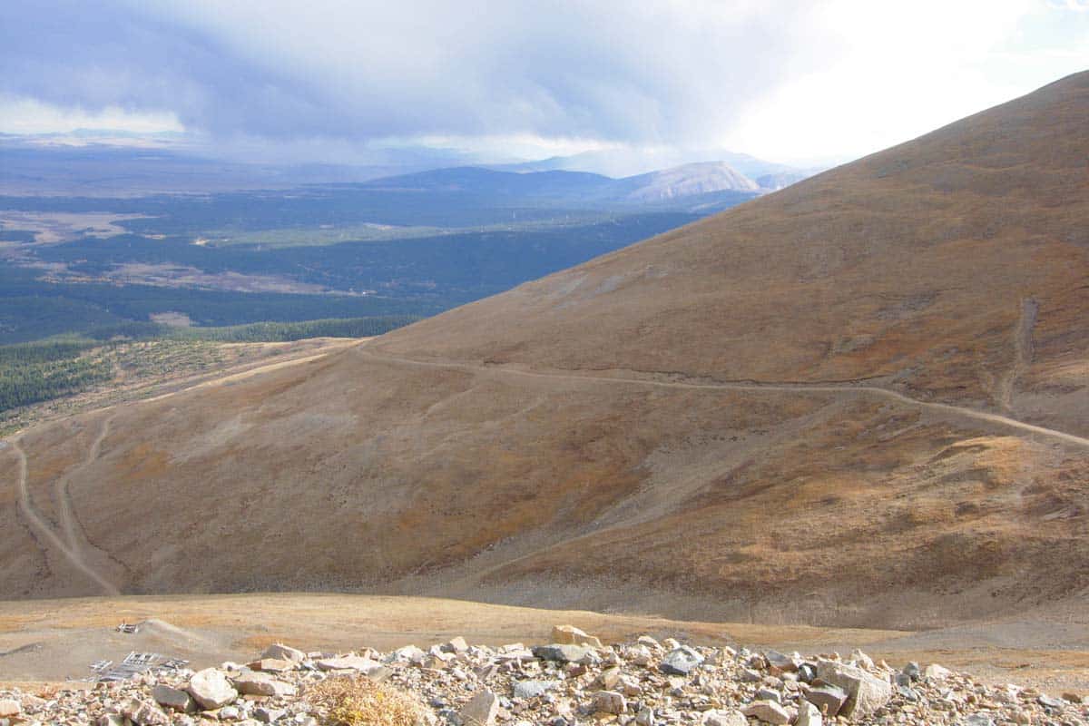

This thread shows how the Binger Policy was implemented from 1899 to 1904. In Colorado, nearly 4000 mineral survey orders were issued during that time. If you do a mineral survey, there's approx. a 1 in 7 chance it will be bingered. The above example is one of two situations that you may encounter. That being where the patented position of the senior claim is "encountered" before its true position. The corners of the mill site were set on the patented line of the Old Lode.
One might think that only the patented position would control, but that is not the case. Here is an example where the true position is controlling, but not shown on the plat. In other words, the patent position of the senior claim is shown on the plat with a gap between it and the true line whichis coincident with the lines of the junior claims.
This example is on the east side of Mt. Bross. Here are the links for the https://glorecords.blm.gov/details/survey/default.aspx?dm_id=194981&sid=odzjdafp.jq0&surveyDetailsTabIndex=1&apos ;">Polaris Lode, MS248 and the https://glorecords.blm.gov/details/survey/default.aspx?dm_id=271488&sid=ilzgf034.nz3&surveyDetailsTabIndex=1&apos ;">October and Triangle Lodes, MS15289. There are two gaps between the Polaris and the October and Triangle lodes. Please note that the lengths of the side lines are 1175.1 ft. and 1078.2 ft., both well below the statutory limit of 1500 ft. So why not extend those two claims to the side line shown for the Polaris Lode?

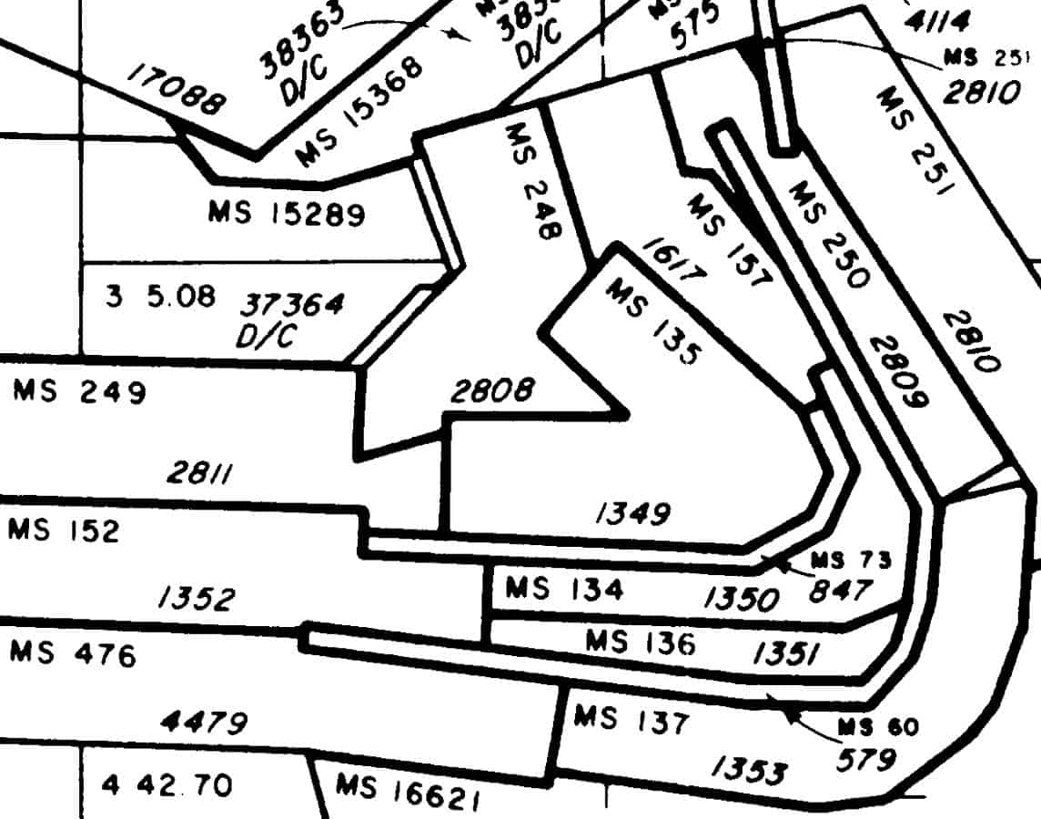

The first image is a supplemental master title plat showing several odd shaped lode claims. Two oddities stand out to me on the plat, those being the small gaps between MS 248 and MS 15289.

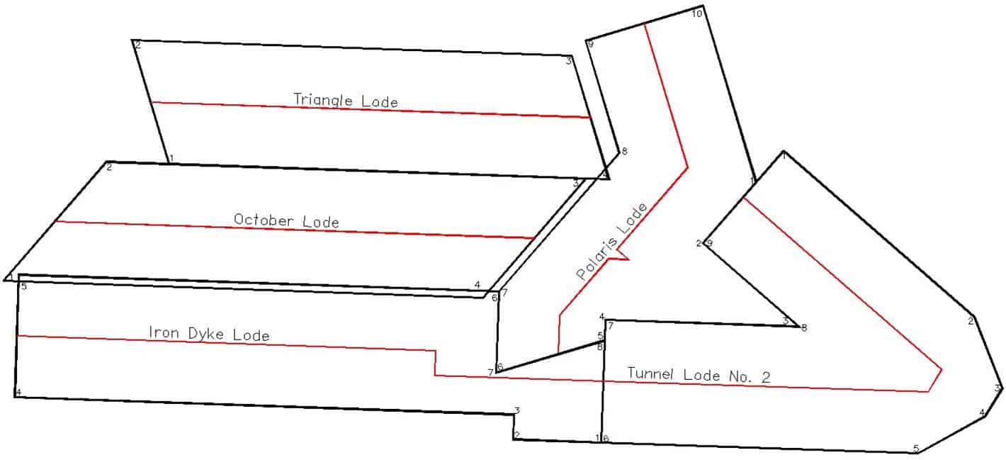

Here is a sketch showing the three claims as depicted on the plat of Sur. No. 15289
The lode lines (red) for the Polaris, Iron Dyke and Tunnel Lode No. 2 are geological oddities, esp. the zig-zag in the Polaris Lode. That is simply explained by one of the requirements of lode claim locations. Both side lines must be 150 ft. from the lode line. If you go 150 ft. northeast of the zig you will be at Line 2-3 of the Polaris, and if you go 150 ft. south of the zag you will be on Line 3-4 of the Polaris. The zig-zag is a fabrication that allows the Polaris to completely fill the triangle and be coincident to the Tunnel Lode No. 2. The Polaris was approved in 1877 before the GLO forbade constructs not based on an actual mineralized vein.
If you look at the plat for the Polaris, you will note that it has a tie to the N1/4 Cor. of Sec. 3, T. 9 S., R. 78 W. of S. 7?ø13' E., 10627.77 ft. The plat for the October and Triangle lodes shows a tie to the same corner of S. 11?ø4' E., 10455.7 ft. The staked position of Cor. No. 4 of the October is identical to the staked position of Cor. No. 7 of the Polaris and Cor. No. 6 of the Iron Dyke (all on the same stone). The October and Triangle lodes were surveyed by W.H. Powless who had to chain nearly two miles so that he could could then use the two-mile patented connection for the Polaris, which show it being 43.4 ft. to the northeast of two lodes!

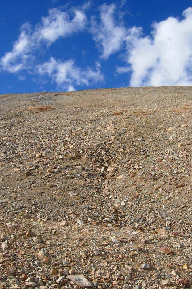

The common corner to the October, Iron Dyke and Polaris is at the top of the ridge at 13800 ft. (photo looking north)
Turning around and looking south at the terrain that Dep. Powless chained across, the Qtr. Cor. is approx. 1.7 miles at an elevation of 11,700 ft.

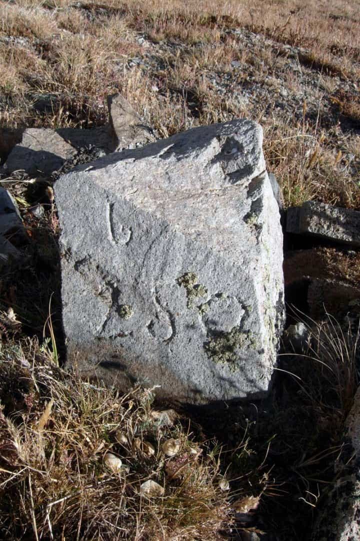

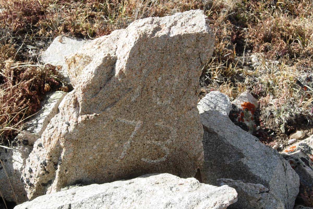

Here are a couple of nearby stone corners for Cor. No. 10 of the Hiawatha, MS 73 and Cor. No. 6 of the Friday, MS 250 that are to the south and east of the claims.
