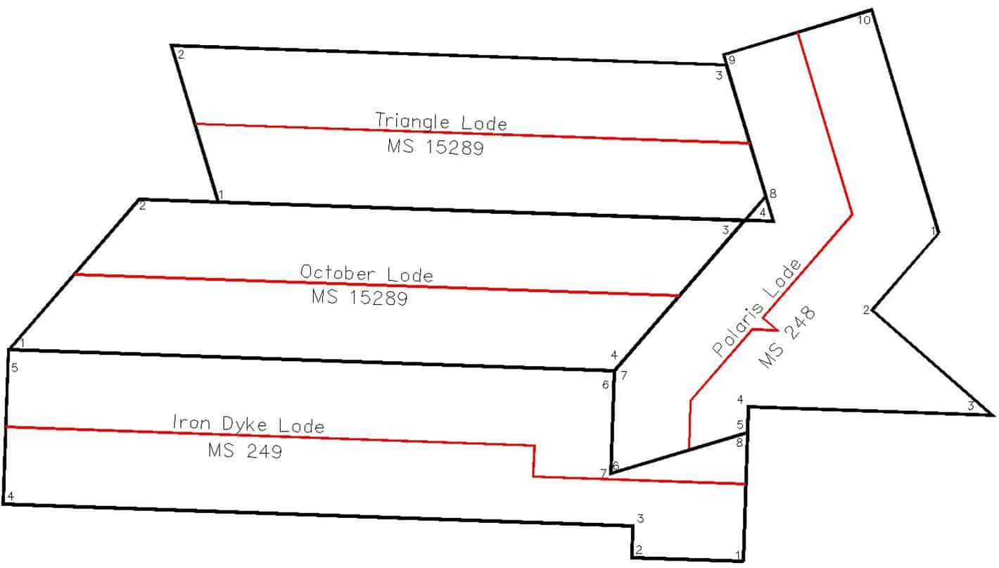

To finish up, the east end lines of the October and Triangle lodes were staked on the true position of the Polaris Lode, but the Polaris Lode's patented position was shown 43.4 ft. to the northeast on the plat. So, in this case there is a gap in the record, but NO gap on the ground because the true position of the Polaris came before the patented position. During the Binger Period, many deputy mineral surveyors left bread crumbs for those that followed their footsteps in an effort to show that they really weren't liars or stupid. Here is what the monumentation on the ground shows the positions to be.
