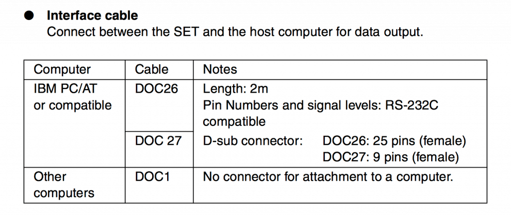

Does any one know how to get data from the sokkia set 610 total station
your help will be my pleasure thanks in advance

This instrument appears to have a serial port. See this page from the manual for the instrument. Others here may know which, if any, data collectors might work with this instrument, but it appears you can output files from it directly to a computer.

On PC you need Prolink software and DOC cable to connect PC & instrument. There are USB versions of DOC cables.
You can download Prolink from the Internet.
Not all data collectors and the software on them can connect to most instruments. Carlson SurvCe software for data collectors
is the exception, it will connect to most instruments.
