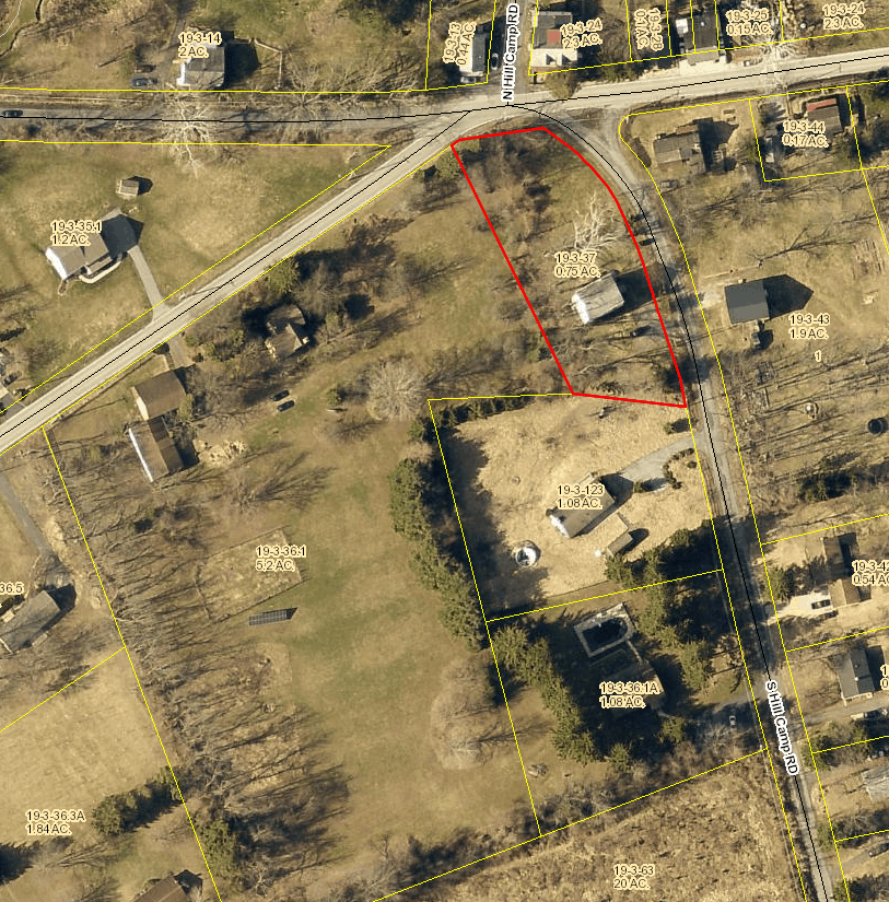

Holy Cow, post: 444396, member: 50 wrote: [USER=136]@James Fleming[/USER]
Is this pretty close to your back yard?
No...this is NW of Philadelphia between King of Prussia and Reading. This is a bigger shot of the GIS

Frankly, I wouldn't think that any boundary surveyor would work in the way you describe these guys doing it. Maybe a firm that mainly does construction staking thinking they an move into boundary. But I recognize that we are only getting your perspective, so I shouldn't dwell on that part to heavily.
Absolutely finding original stones in their original positions are very important. It can clear up a lot of problems, but don't leave that as the end-all. (The "in their original positions" should be emphasized, when talking to a non-surveyor) I wouldn't employ a real estate lawyer this early in the game (although it might not hurt). I agree with whoever said that the best thing you might be able to do is get a recommendation from a law firm for a good local surveyor, someone they use as an expert when they do go to litigation. Remember that attorneys can give you good legal advice, but they are not experts on boundary.
It's true that the surveyor's staking of the property line is their "opinion" but they are licensed to be able to give expert opinions and no one else is. Since this is a boundary location issue, that is the area you are needing to look. Title insurance is more akin to determining and insuring "who" owns the property but not "where" the precise location of the property is.
As far as getting into a dispute with your neighbor, you have to keep your emotions out of it. If you are absolutely right, a legal dispute can still cost a lot. Definitely weight the cost of giving up a couple feet of property (if that's what it comes to) vs. spending thousands of dollars on litigation which you may or may not win.
Anyway, I am mainly repeating what others have already said. Good luck.

Your parcels were likely part of the same parent parcel as the adjoiner. If so, then the date(s) when the larger parcel was divided into smaller pieces is important, due to junior/senior rights.

Yes, historical aerial photos, particularly when rectified against modern aerial orthophotos, can be extremely useful for making sense of old deeds that refer to vanished or questioned landmarks.
Posted : September 1, 2017 9:13 am
Kent McMillan, post: 444456, member: 3 wrote: Yes, historical aerial photos, particularly when rectified against modern aerial orthophotos, can be extremely useful for making sense of old deeds that refer to vanished or questioned landmarks.
Here is one from April 17, 1968
Posted : September 1, 2017 9:22 am
Dan B. Robison, post: 444461, member: 34 wrote: Here is one from April 17, 1968
The way that I handle similar historical aerial photos in Texas it to download the images from the USGS server (the 1951 image is available for free on line) and rectify them (or some portions of the images surrounding the parcel of interest) in [REDACTED] using features that appear in modern high-resolution aerial orthophotos for control. In terrain with lots of photo-identifiable control points, it works quite well.
Posted : September 1, 2017 9:37 am
Another method is to reference the photos in chronological order, and using [REDACTED]'s translucency tool, create an animation showing the evolution of the use lines.

Help!, post: 444388, member: 12997 wrote: I contacted a second survey company, but now am nervous that I'm going to have a very expensive repeat of today.
Use the responses in this thread to develop questions to interview surveyors to figure out who you should go with. Find the right surveyor then get the estimate. Don't let price guide you as going with the cheapest is almost always the worst choice, and going with the most expensive solely on the idea that you get what you pay for could be misleading.
Some have suggested getting a recommendation from a local attorney. The problem with that is that finding an attorney who has enough knowledge in boundary matters to be able to know and recognize a highly competent boundary surveyor can be more challenging than finding such a surveyor on your own.
Help!, post: 444388, member: 12997 wrote: Also, what are your thoughts on magnetic north? Can I find more info at the county office?
County won't be much help. If you want to satisfy your own curiosity, follow the link Kent provided. Otherwise, when you speak to other surveyors, be sure that you get a level of comfort that he or she will be diligent and thorough not only about considering magnetics, but in all areas of research and field investigation as well. Also make sure you hire someone who won't mind taking the time to explain their results to you.
Help!, post: 444388, member: 12997 wrote: I'm thinking of just offering to buy 15 feet of the neighbors land so we don't have his yard trash stacked up out the back door. I don't know if he'd accept. Stubborn.
If your neighbor is the type to put you on notice by building a brush pile next to your house, this is probably a non-starter. Get trustworthy survey results before deciding any next steps.
Help!, post: 444388, member: 12997 wrote: Both of our lots have very old deeds dated back to the 1800s and written in perches.

Evan Page's analysis is absolutely spot on.
eapls2708, post: 444550, member: 589 wrote: a boundary survey is an investigative task primarily.
Evan said that in so many good ways. I'm glad to see you getting solid counsel.

eapls2708, post: 444551, member: 589 wrote: If you do end up suing this surveyor
As you can see, boundary issues can be complex and esoteric. Explaining the problem with boundary establishment in court is a crap-shoot: you never know what the courts will understand, what they'll hold, and how their ruling will fall. You could end up being responsible for costs in excess of the value of the land AND be held to a worst-case scenario boundary.
Exhaust all options to work this out without going to court before considering that option - it's rarely beneficial to either party.
You may be correct in your assertion (and the findings of an expert boundary surveyor) but once it's in the hands of the courts - validity, correctness, and the quality & weight of evidence may be lost in the complexity of the case (especially when spun by a skilled litigator) and may not be properly considered in the findings - sometimes the ruling magistrate/judge doesn't understand boundary law and they may rule in a manner that is at odds with the facts.
IF you do get a survey that supports your position - be sure to file a Record of Survey (ROS) (or the PA equivalent if they don't have one) to perpetuate those findings and reduce the potential of a contrary location being asserted. If the surveyor includes the rationale for their findings on the ROS, it is more likely to be adopted by other surveyors and, over time, may ripen into accepted evidence of location.

Because of what JKinAK said, one of the most important traits you should be looking for in a surveyor is both a willingness to explain how they arrived at their results and the ability to express complex technical and legal principles in non-technical, easy to understand terms.
Some surveyors don't like to explain anything to anyone. Still others can clearly things across to another surveyor, or at least to someone who can follow a technical explanation. A surveyor who is comfortable with and capable of explaining the complex in simple terms is one who is very likely to be highly competent as well as confident in their knowledge, and is also not common.
