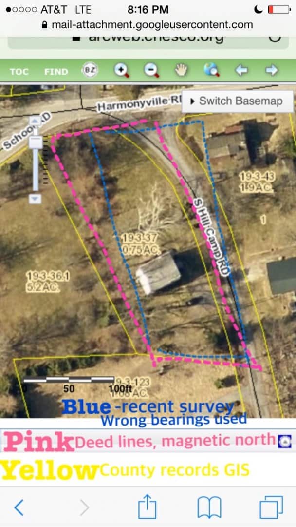

However we DONT have two surveys that match. The neighbors 1982 survey has our bearing wrong and today's surveyor copy and pasted that same 1982 survey. So the line was put at a different degree than the deed. He stated that he can't know exactly where our boundaries are without the neighbors deed, so he has to change our deed bearing to fit the neighbors survey. I could understand if this was after finding the landmarks, but this is without finding any landmarks. He agreed that if he had the neighbors deed it would likely come together better, but he didn't have their deed information and so this was the answer- change our deed.

Bill: I was told the bearings MAY be magnetic because of the deed age. The reason I think they are is that magnetic bearings don't put the school yard (where kids played) in covering the entire road that was preexisting when the schoolhouse was built. See pic. Also, magnetic north matches pretty well with the stones mentioned in the deed. Thirdly- since the surveyor dismissed it entirely, saying he had never heard of magnetic north, I feel like that a thorough investigation was not done and am trying to do some legwork to see if the deed is indeed magnetic. I didn't go with the lowest quote- or the highest. Right in the middle. The highest quote seemed rushed and said they don't make small projects a priority on their calendar so they wouldn't be able to get me in for a while. I know it's not a lot of land, but obviously homeowners like myself with smaller lots want to be an equal priority.
Whew! That was a lot of typing! Thank you again for your responses! I contacted a second survey company, but now am nervous that I'm going to have a very expensive repeat of today. All local recommendations welcome! I honestly don't know how much more surveying we can afford, but will take out of savings for one more. Also, what are your thoughts on magnetic north? Can I find more info at the county office? I'm thinking of just offering to buy 15 feet of the neighbors land so we don't have his yard trash stacked up out the back door. I don't know if he'd accept. Stubborn. One more thing, we don't have wifi yet so I'm on my cell, with no reception in these parts unless I stand in one spot in the yard or the front of my house. Not easy to do with the baby fussing- so if I go mia that's why. Thanks again!

I note that this lot is in an area known as HARMONYVILLE, in WARWICK Township, Chester County, PA. The Chester
County GIS appears to be rather clunky. Deed origins in this area predate Daniel Boone. I am surprised that a school parcel from that era would be that large.
As best as I can see, this parcel lost area to various road relocations and research would require searching road returns for three different roads, typically in county archives, not necessarily the courthouse. Possibly getting the original patent map from the state archives. Complications are the 1982 subdivision sets a solid timeline for possession.
This survey may be a lot of fun and expense, but no one can really promise you what you seek.
