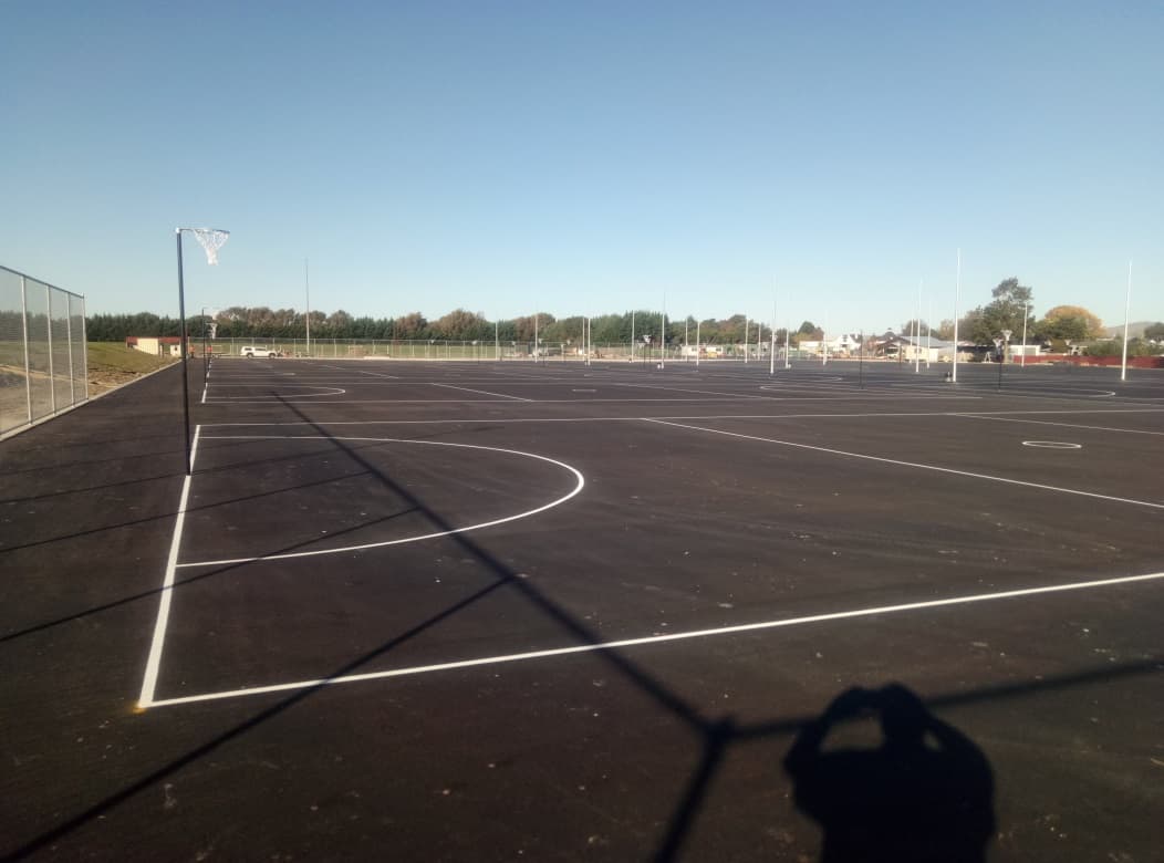

I generally agree with all the comments cautioning about using GPS for set out.
I was particularly concerned about my current project, as all I have is GNSS South S82V. I would have preferred some form of total station for some of the work. Previously only used the GNSS for earthworks and road set out with aid of a optical level to confirm heights for pavements.
I have been pleasantly surprised how everything has worked out. Checking points from different localisation points on different days and getting remarkable, seldom differing in position, often within 10-20mm in height.
I kept telling the contractors the best I could set out was the size of the spray paint can base, 65mm diameter circle. And I joke with then that "I don't know why I bother, as they seem to knock out the pegs/nails or ignore them"

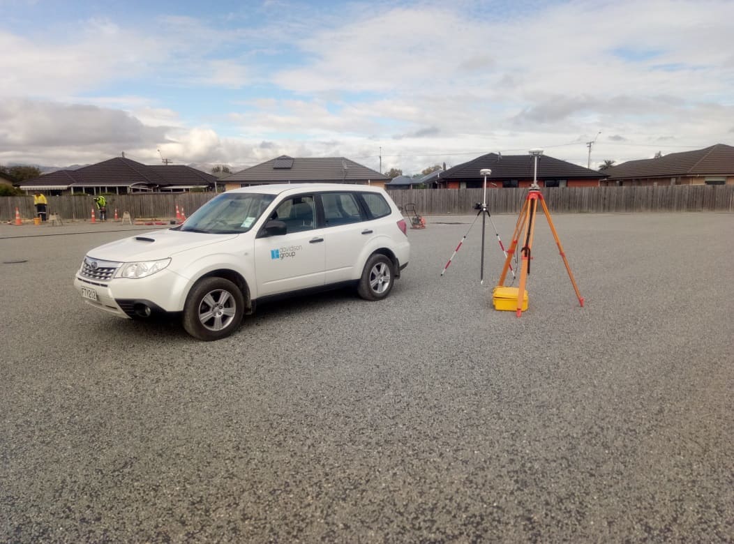

I took care to adjust and check the pole, having made my own jig, use a bipod for the critical points and maintain north orientation as an added precaution.
I had a clearly bad set out point when laying out electrical ducts, not a GNSS issue.
One point seemed a little off when doing car park markings, perhaps 50mm. However I set out 15 netball courts with nails in corners and all the other lines and centres, the post sockets set out previously prior to asphalting. The line markers set string lines and checked dimensions and square and only wanted to shift a few nails, all more of less +/- 10mm which is the best I could have hoped for.
On a different tangent, the office vehicle I get to share is a small Subaru Forester 2.0 Diesel. Full size trucks are a rare sight on roads in New Zealand.

I googled 'Netball' to see what that was all about and this was the first link: http://www.stuff.co.nz/marlborough-express/sport/92091935/new-netball-courts-officially-opened . What are the odds that's your work?

Yes that's the one. I had not see that report though, so that's for the link.
