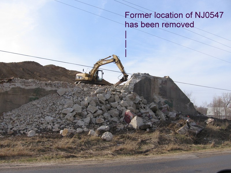

I arrived at a bench mark I had previously seen, to do a GPSonBM session, and found fresh equipment tracks next to the broken off post. It was the only found GPS-able mark in about a county area.
Another time I sat in the car and watched a jackhammer on a crane take out an old abutment with the most stable high order?ÿ bench mark for miles around. I knew it was going to happen and went to watch. I saw a survey crew on that project and asked if they had done a reset and they looked at me like I was speaking Martian.

Too late as construction work had started in the area before I heard of it, I don't think my leveling equipment meets NGS requirements, and i couldn't have attempted that much elevation change without recruiting help.

Moving an NGS monument to their standards would be a big job these days. I did a few of them years ago, but the most recent proposal to shift one was rejected by the client that was taking out the old one as too expensive. We ended up setting a new monument, leveling to it and OPUS ing the coordinates but not to the standards required by NGS guidelines to allow it to be included in the database.?ÿ
When we added the meetings, the reports, the submittals ect to the cost, the client said no thanks.
