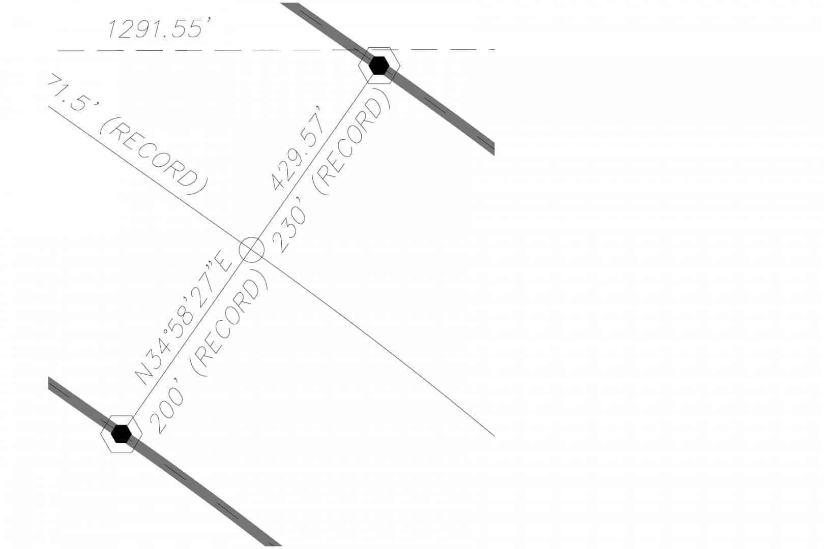

My latest one, on a federal highway (land is owned by the state in fee):
The description was 200' to the left and 230' to the right of centerline. Pretty typical for these parts

MightyMoe, post: 414668, member: 700 wrote: My latest one, on a federal highway (land is owned by the state in fee):
What are you going to do?

aliquot, post: 414670, member: 2486 wrote: What are you going to do?
Go 200' to the left, and 230' to the right of the centerline.
I will file the ROS if the client gets to that point, the right of way fits the deed so......
