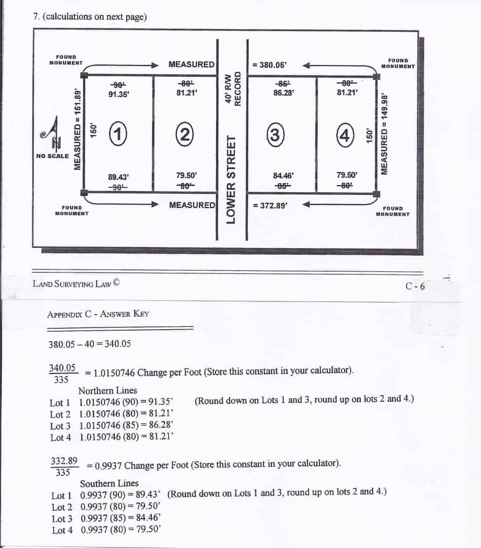

Hey Leonard - good to hear from you!
So you would argue that a subdivision plat does not simultaneously create ALL of the parcels therein?
You missed Ron Platt's earlier statements "It is quite clear that to consider a recorded and platted subdivision anything but only one survey, we would also be throwing turmoil into the well settled rule of law for proportionate mwasure in a subdivision.
When a plat that purports to dedicate right-of-way to the public is shown on a subdivision map, it is only one of the many parcels that is created equal. At the very instant of time that the plat is recorded, the title passes to the city or county. This is not a senior conveyance, merely the first parcel that changes ownership with equal standing.
No cases were found during the research for this paper that would suggest the streets to have senior rights over original monumentation, and to consider the streets as a senior conveyence over monumentation would defeat the theory behibd a simultaneous conveyance, not to mention the case law presented herein."
I prefer to follow case law, the theory of simultaneous conveyance (properly applied), and not the "general rule." My concept is not erroneous - a subdivision plat creates all of the parcels equally. Period. It appears to me that it is the "general rule" that is erroneous.

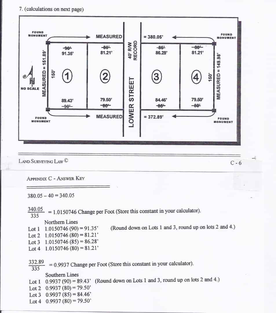

I guess it depends on your state/regs. In QLD Australia the 'Road Lot' has just as much rights as the free hold.
If there's 3 properties with 20m frontage and a 20m wide road and you have 81m between marks at either end (obviously wildly outrageous made up numbers) each 'Lot' gets an extra 0.25m (assuming there's no other evidence to suggest where the excess falls, like occupation etc).
So each of the 3 lots now has a 20.25m frontage and the road is 20.25m wide.
Same goes for the other way, roads have no more rights than property. If there's shortage, road gets that too.

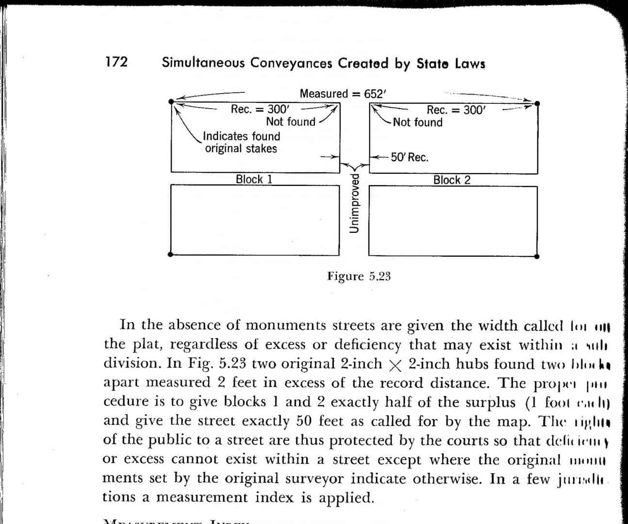

A street is not a parcel. If it were, the assumed owning municipality could sell it off and take away your use of it.
Let us assume a 50' right of way. That is 50' for everyone to use and there is a greater need for the public to be made whole than any series of lot owners.
However I have come across filed maps that show a 50' right of way on perimeter streets but the original tract never held the full width. That was a hope and a prayer that the adjacent parcel would develop and make up the shortfall, which sometimes never happened. I owned seven lots in an unbuilt subdivision with several on a perimeter street that in reality was 7' to 38' in width. That street was not needed to make all the lots useful and it disappeared into adjacent original lots.
A street may not have senior rights as we understand them but does have superior rights to individual lots.

Jim, very few would arge that streets have "senior rights over original monumentation". If the monuments are there they govern.
The question is how to proportion when the monuments are missing. Robillard was only able to find one court case were the streets were proportioned.
I am licenced in Arizona but have done very little work there. Are you aware of any precedent setting cases in Arizona that instruct us to proportion streets?
Posted : August 24, 2015 8:33 pm
Paul in PA, post: 333318, member: 236 wrote: A street may not have senior rights as we understand them but does have superior rights to individual lots.
So in the instance of this pdf example, the NW Cor. of Lot 14, Block 1 would be set at 24.25' from the NE Cor. of that Lot?
ELM St width.pdf (11.9 KB)
