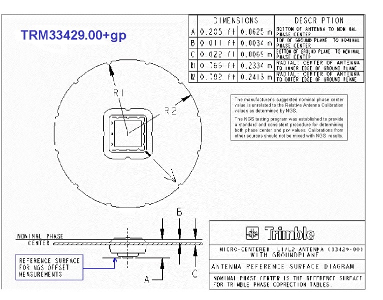

How do I make sure that I have the correct value to submit to OPUS for the ARP? Trimble 4000 series mentions something about corrected height, what impact does this have on deriving the correct value? the antenna I am using has a ground plane.

As the diagram above indicates, the ARP is the bottom of the preamplifier housing. It's the lowest surface on the body, the one that mates with the top surface of a threaded adapter.
